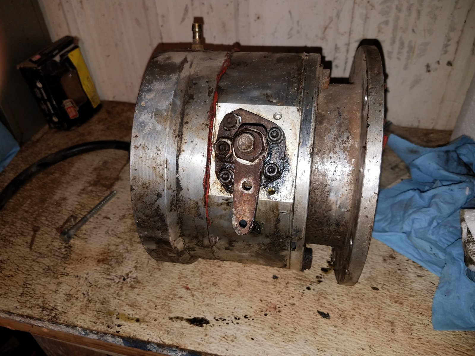

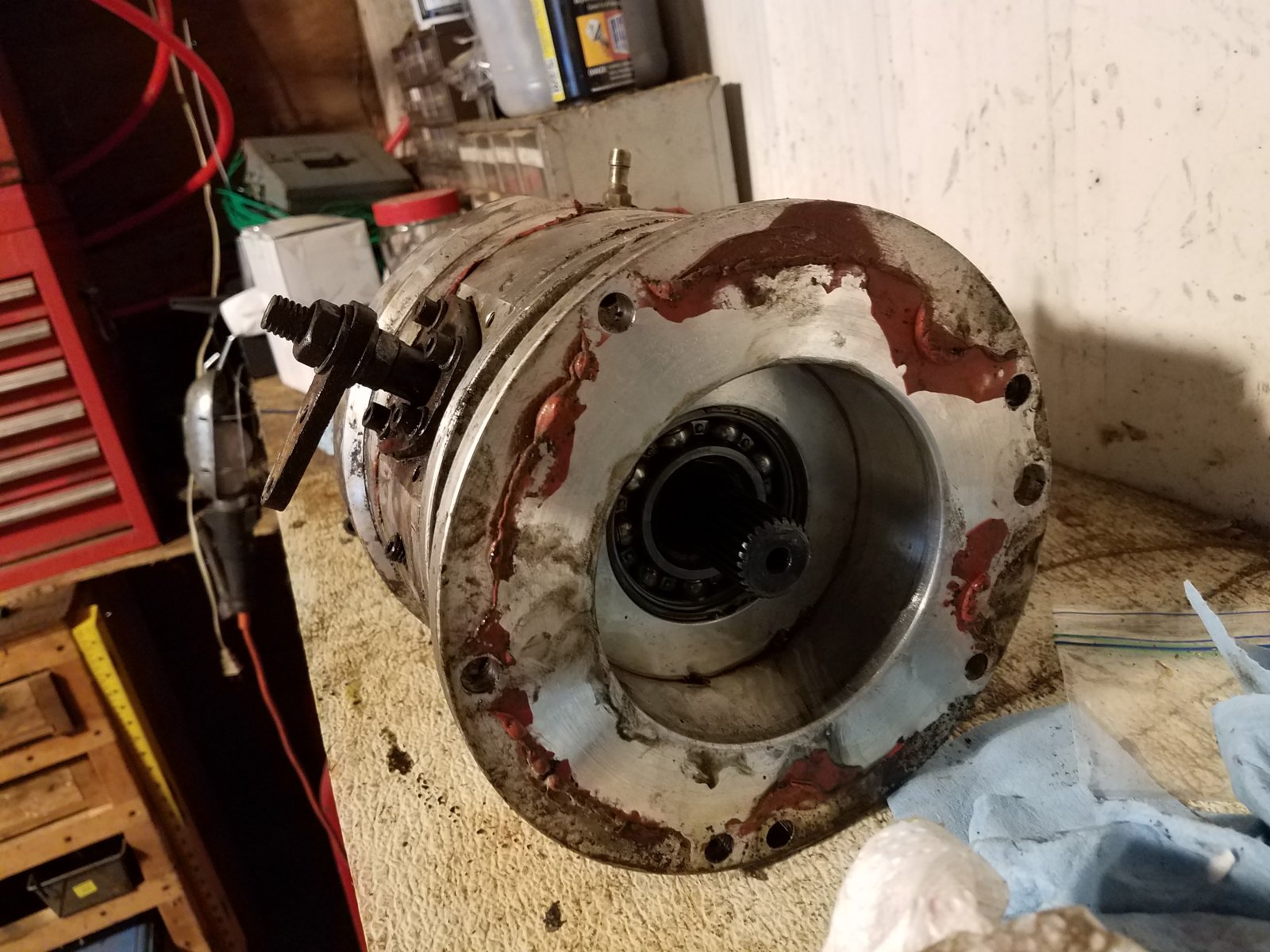

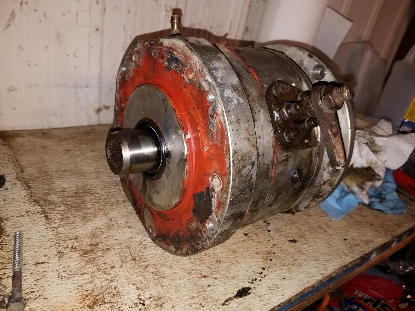

Doubler is out. It still works as it should but I am getting fine metal particles on the magnet and the shifter is sloppy.

Doubler is sealed up tight and back in. I took advantage of broncograveyard.com's november 10% off sale.

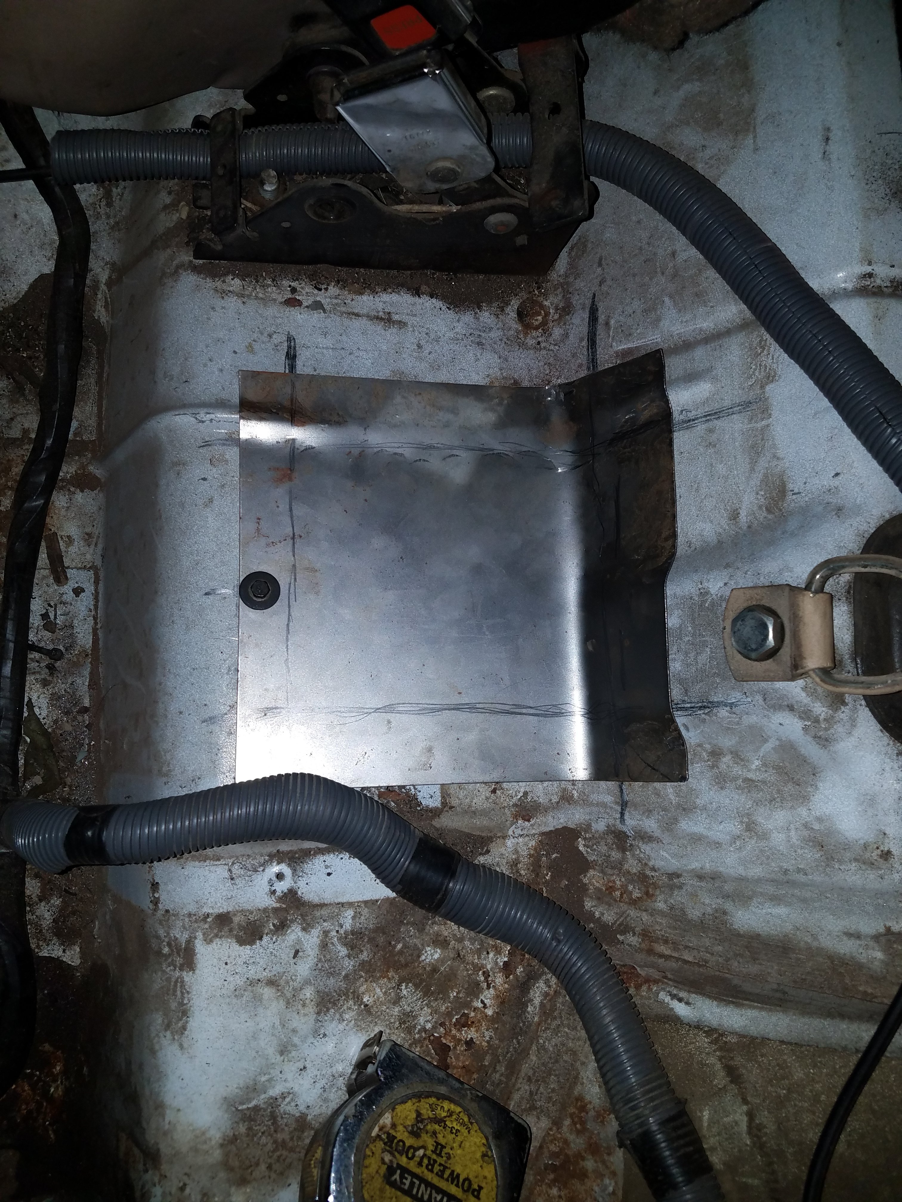

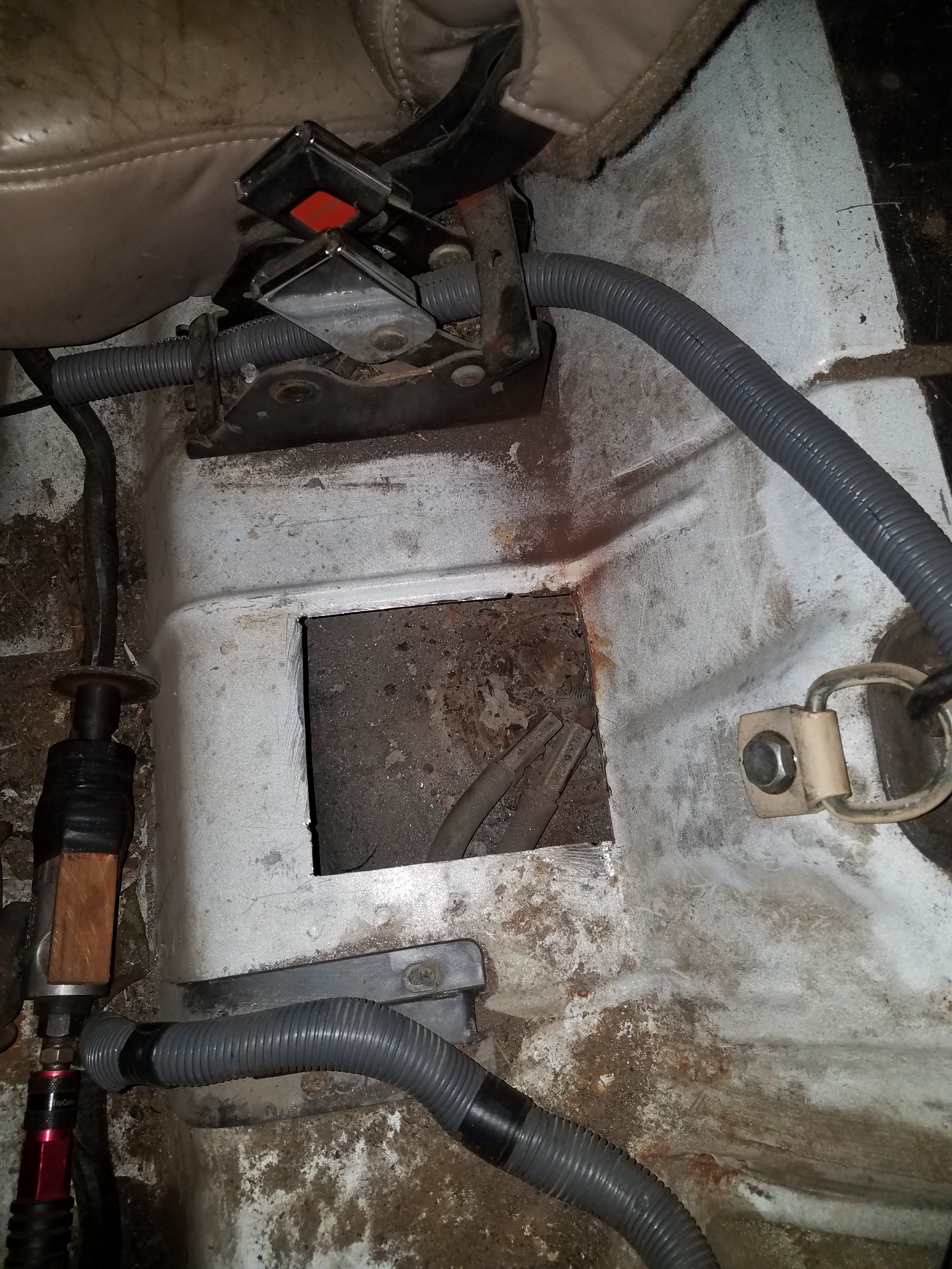

I cut an access hole into the floor so I can get at the fuel pump without dropping the tank.
I cut more than this out but forgot to take a final picture.
Four0Sport
Jack Pewe
August 26, 2004
3,029
106
West Virginia
1993 2dr
I did the same last year. Covered the hole with 1/4" rubber. I cut way way too much out though, almost double what I needed.

Clean cuts!
With the pump under, and the double layers of sheet metal, my cuts don't look as Purdy as yours. Lol
A member called me lazy for doing that, but obviously has no clue what it would be like, to have a pump fail on a trail.

I tried to avoid cutting the floor so I dropped the tank when replacing the sender. Lines on top of the sender were rusted through. A few months later I had a no start concern and instead of dropping the tank again I just cut an access panel. Problem was not the pump, but it is there for next time.

Clean cuts!
I drilled 1/4" holes at the corners and used a reciprocating saw. I was surprised myself how clean it came out. I had the urge to use the plasma on it, but my better judgement told me otherwise.
It seems kind of foolish to call you lazy for doing something automotive manufactures should design into all vehicles!
I thought about using rubber but ended up going with a piece of sheet steel. I have been wanting to cut this out for a long time now, so I figured I would do it before I regret not!

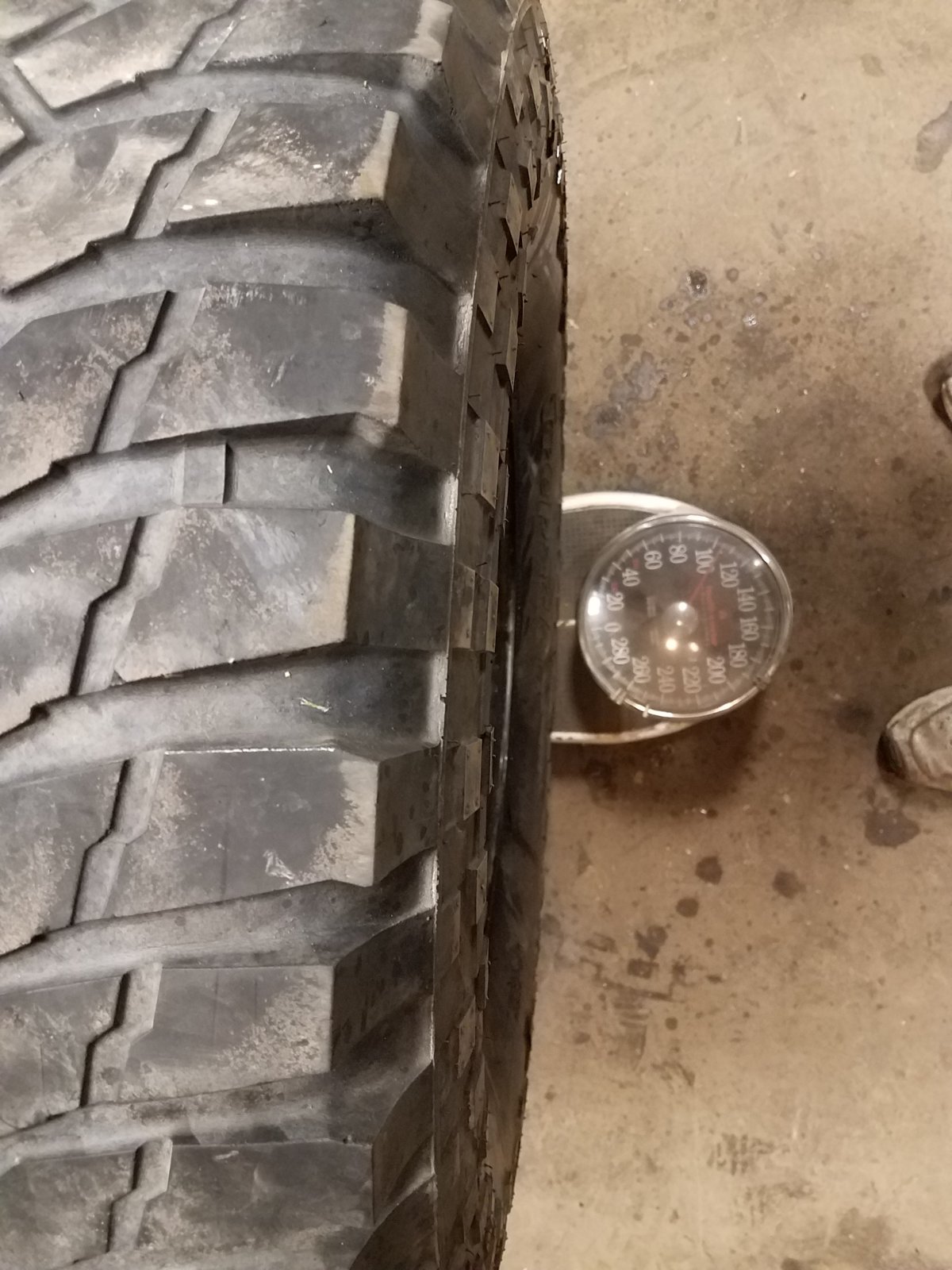

Full axle freshen up
It's cold out so bring your tires indoors
37x12.50r17 cooper stt pro vs low tread 35x12.50-15 Ltb
I mounted the tires myself because I am cheap af. I used air soft bb's to balance.

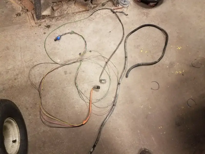

Rear brake line blew out at the gas tank while winching the neighbor's rv. Thankfully I was anchored to a tree
"trail fix"
I found my fuel pump/rear abs wiring was laying at the bottom of my frame rail, creating a pocket for dirt and road salt. Easily rotted my not very old brake line.
I removed the wiring and depinned the abs wires because i eliminated abs when I did the solid axle swap
I reran the wiring on the cab and made zip tie mounts to keep out of harms way and from collecting debris
Also ran the new brake line up high with the fuel lines
My frame is really rusty in that area now. Live and learn.
I bought fluid film rust prevention spray to under coat it someday. I have been using that stuff on my diesel truck and it works really well
