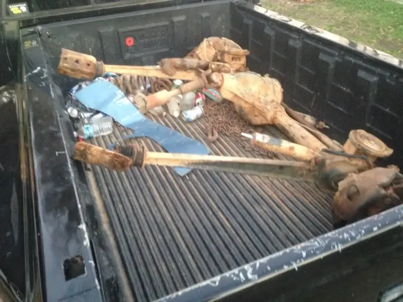

Okay, I just bought my front axle and figured I could start this thread up.

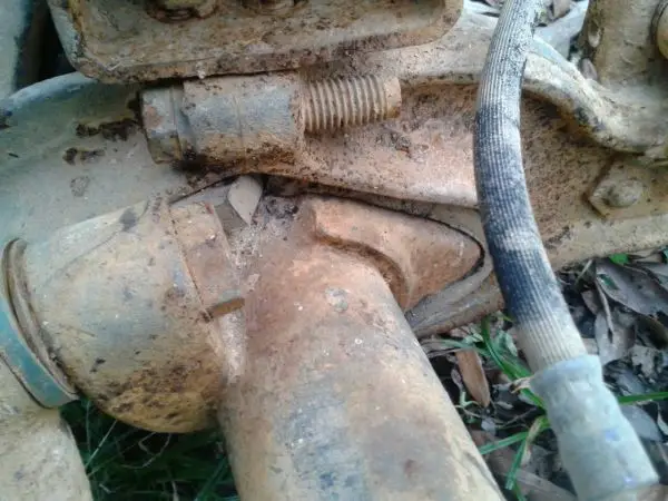

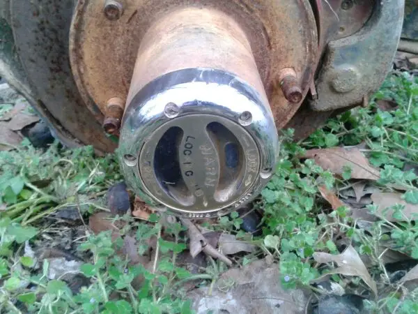

She needs some cleaning:

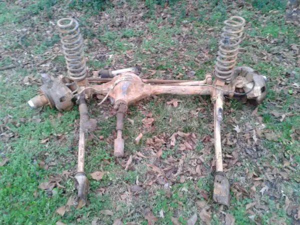

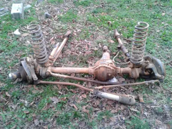

1977 High Pinion 44 without the cast wedges.
5x5.5 lug pattern
Already set up for disc brakes! :D
Carrier is very clean
3.50 gears, for now
Complete steering
This will get 4.56 gears and run 35" tires, most likely Duratracs.
