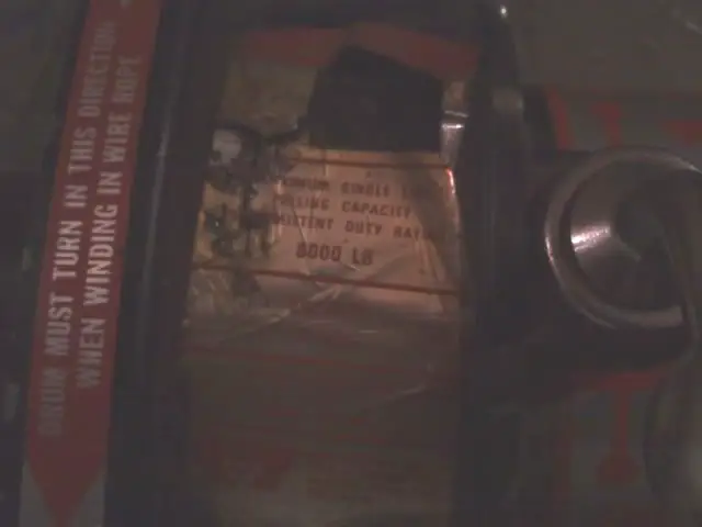

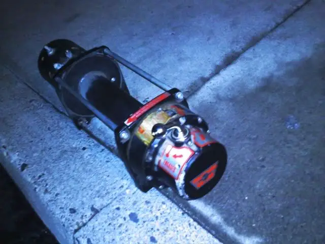

Warn M8000 Winch
Got it for $50 from a customer tonight cuz he needed gas for his rig (I work at a gas station)
How would I test it?
sweet deal!!
tested it tonight and it works... a little bit loud but i can tear it apart and rebuild it.

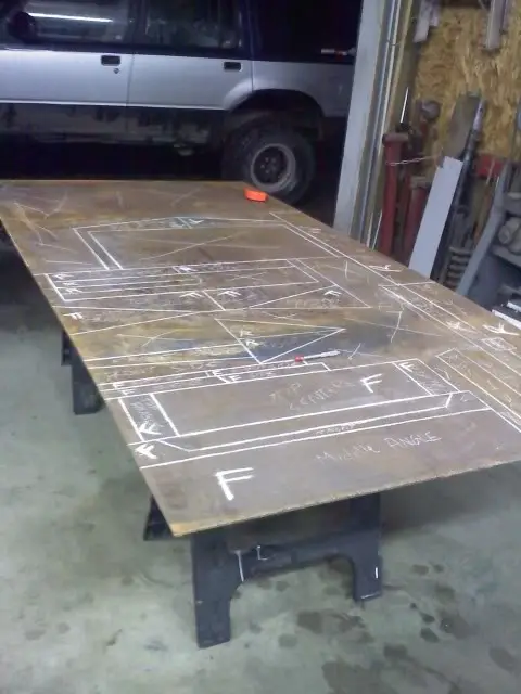

Progress!!
Started out as...
and then...
and then...
and then...
and then...
and then...
and then...
NO MORE AND THEN...

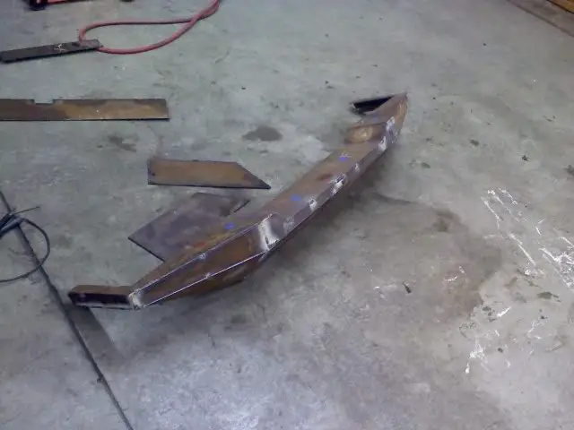

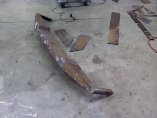

should I stick weld the main points and then is mig ok for the rest?
Well front is almost done. Pics in a bit
making progress...
tacked...
Burned in, mostly grinded...

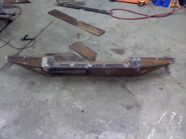

more front pics...
Not fully mounted, just set up to get bolt hole locations, etc...

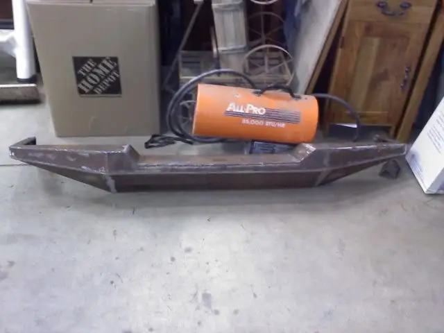

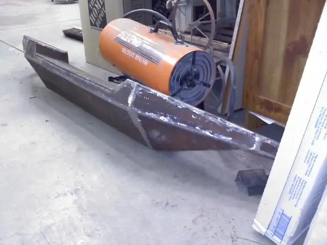

New rear pics...
the rear is 6" wider to fit my flares and protect my rear quarters

its almost done, i just have to burn 4 welds in and then grind it all down to make it perty. should i use a flap disc or go old school and shape it with a grinder? i have 80 160 and i think 320.
start out with the grinder and then finish it up with the fine flap disc. It will come out looking baby butt smooth. You will also want to rough up the entire surface with the flap disc to remove any rust and pickling so your primer coat adheres the best.
