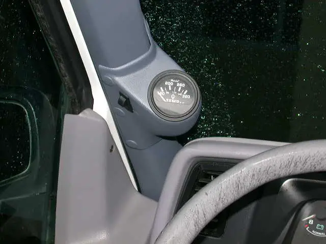

you mean this?
ATM-15309 for a Ranger

Yep...like Albino said....If it doesn't exist for the Explorer, try looking for it as a Ranger part...more than likely you will find it there....

Sweet guys thats exactly it! I just need a two pod version. I was told that ranger pods would not work. Guess they were wrong!

I put in a 2-gauge pod made by Autometer in my '92 XLT. Probably is a Ranger unit, but I'll send you the part number when I get home from work.

I bought an Autometer 2-gauge pod from egauges.com. It is part number ATM-15308. It is listed as fitting 95-99 Explorers, but it fits my 1st gen 1992 XLT perfectly.
