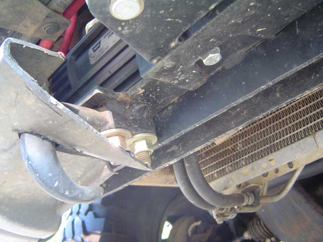

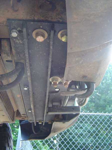

took a few pics today. its hard to see what's going on really with the bumper on and the winch in place. its pretty much a flat plate that goes under the frame rails. has ribs welded under so it doesn't bend. has a flange welded to the plate that sits flush with the inside of the frame rail and has one bolt through the rail horizontally. there are 3 bolts through the bottom up into the frame rail. (each side). i welded a piece of angle to the front and cut out a chunk for the wire to feed though. that's where the fairlead is mounted. also welded and bolted a tow hook for quick pulls.
had to relocate the trans cooler which wasn't hard. had to cut lots of bumper. had to cut plastic around the inside of the grill to mount the control pak. hope this helps. i've only used it once other than the first day and that was to pull up some stumps. money well spent? we'll see!!

Where did you relocate the transcooler to?
Is that a tranny cooler or the factory power steering cooler? Looks real good. I always wondered how a winch would mount up, and that looks fairly straight forward. I could definately machine up a plate, just have to save up some cash, and get the nerve to hack up the bumper. :)
relocated the trans cooler just up about 6" from where it was. mike, the cooler you see in the pics is the radiator. :) the hoses that go under it and that go up through the winch plate go to the trans cooler.
there really isn't anything to the plate. its just a flat plate bolted up to the bottom of the rails. i put welded supports that fit inside the frame and bolt throught it as well. then welded the "fins" on the bottom for rigidity. weld a piece of angle up front to mount the fairlead and cut the bumper all to hell. mounting the control pack was tough because its hidden too. its behind the grill off to the driver side. that required more plastic removal.
