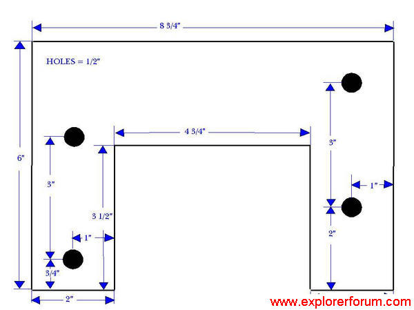

I have the same exact explorer as yours, expedition package as well, mines white, I'm going with the performance accessories 3"bl 853, which is for ranger years 95-97 I believe with the correct steering extension, just have to fab bumper brackets from what I understand from my reading, but if your going with a 4" lift none of this helps you, but keep in mind the 3"bl from pa is going to be a lot cheaper than the 4" lift ;)
that sounds good, yea the 3" would be good enough and all i have to do is fabricate some bumpber brackets and get the lift kint for the ranger from 95-97

Highfly...you might find all you need is the shackles...it would probably sit with a bit of a rake. As far as your bl goes...the same as above from what I know, get the bl from Performance accessories for a 95-97 ranger and fab up your own bumper brackets.
For everyone: You can actually make your own steering extension, a member here did with a couple of u-joints...dont know where the post is but you might find this is a nice solution since you might get some binding in the steering even with the extension. If you did though it wouldn't be bad or anything. I seriously considered going with a bl too, but I didn't want to have to deal with the the manual shifter extension.

nice i may have to look into doing that. if you do this can u send some pics of your bumper bracket?
Here are the templates for the bumper brackets, I got them off of another thread. :thumbsup:
