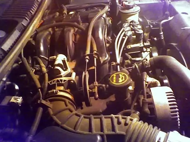

Can't find it either...
I'm having the same problem... I can't find the PCV valve. I've found several pics in different threads here, but none of them seem to match my engine. (2002 Explorer XLT 4.0, non-flex-fuel.)
Here's a pic of the engine, if it helps (throttle body cover removed):
Can anyone spot the PCV valve? (I guess it's probably over on the driver's side, but unfortunately I don't have a pic handy from that angle.)

It is located in the back right hand side of the intake manifold, between the intake manifold and the firewall. It is a pain to reach.

Thanks, Joe. I'll get under there and tackle it again this afternoon.
Assuming you mean driver's side when you say "right" ?

Yes drivers side of the intake manifold.
Basically one of the worst places to locate the PCV

on the 2002-2005 4.0L ohv motor look on the divers side valve cover on the back between the valve cover and firewall look for a hose on the intake manifold and the valve cover it is in the back of the cover and once the hose is removed the larger one on the back of the manifold and gets smaller on the pcv side it is a u shape hose goes from the back top edge of manifold down to the back of the valve cover it is located in the very back edge of both the manifold and valve cover side on the drivers side i can post a pic if i am told how to thanks and hope this helps mine is a 2003 I was told that 2002-2005 ohv 4.0l are all the same.

Found it, thanks.
