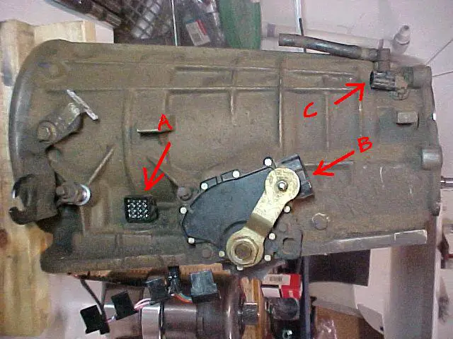

A-where the solenoids and input sensor hook up
B-where the shift selector hook up
C-where the output speed sensor hook up
These are the electrical signals that have to get from the computer to the tranny. The 4R55E is electronically controlled, so if any of these connections are not made, it won't engage. I'd unplug and replug each one of them to make sure you have good connections.

Those electrical connectors have been checked many times including the connector to the transfer case. They are tight and click locked.
