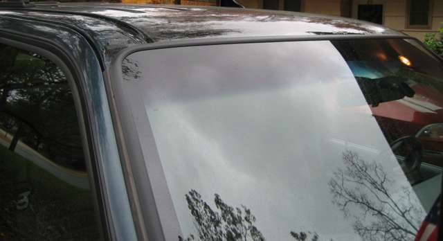

Here you go Charlie...Here is a picture with the new windshield installed. I actually didn't post a before picture since I was in a hurry to dig in and get it done...
Good job!!! It does demonstrated that you're good at bodywork. Congrats on your fix!!! :D :thumbsup:
