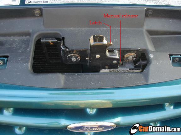

If you have a warranty on it, try it. I don't what they did, I just quickly changed my oil right after it. So you unhooked it from the handle, and pulled on it using pliers? Mine was really corroded and that was part of my problem. I'm not sure if I threw away my original parts, I could find out, but it wouldn't be until next Wednesday. If you reach up between the radiator and the grill, you can actually reach up to the latch, but it's all by feel, you won't be able to see what you're doing. There I used a hook and tried pulling on the cable that way, but couldn't pull it hard enough to get it to pop. So the easier way is to try inside the cabin, unhook the handle, get a really good grip on the cable and pull. I wonder if you could also pop it with a screwdriver reaching up from outside. I eventually gave up since I needed my oil changed so badly and went to the dealer. The parts will need to be ordered ahead of time, so if you plan on replacing them yourself or having the dealer do it, you may want to do that soon. Unless your dealer happens to have a few in stock.
If you look in this picture, you'll notice the brand new latch, but they reused the original bolts, they look like hell. The operation on my new one is super smooth, it pops up really quickly and if it wasn't bolted down it would fly away.
Edit: Also if you look in the picture, you'll notice the exposed cable on the lower right side, that's what I was hooking and trying to pull. I forgot about the part about there not even being enough room to get a screwdriver up there. Bad for crooks, bad for us.

Me and the rest of the people that get frozen hood latches. I lube mine about 3 times per year. I will shoot some PB blaster or WD-40 in the latch and manually open and close it 30+ times. I outlined EBInterceptor's pic to show the manual release. You just keep the hood opend and move the latch down; as you do this the manual release will move into it's locked position. To manual open the latch you take a flat blade screwdriver and push the manual release down slightly and then to the right; the latch will pop open. I then dry it out with my air gun and lube it it with some spray lithium grease.

DeRocha- That manual release, I think I can see it through the gap between the hood and the grill shell - think I could pry it open like that? I dont think I can get enough leverage with a screwdriver - so what culd I use. I am starting to draw blanks. Thanks! But one thing I'm thinking - isn't it a little soon for mine to be freezing up? Its a 2000 and it hasn't even gotten extremely cold yet (lowest has been maybe 35). Think I should try a blow dryer on it to kind of free it up?

DeRocha - Well, tonight I tried again...took a screw driver and tried hammering on the actual latch. I tried the manual switch, but I can't tell which way you have push it - up or down? It didn't seem to want to move either way. The thing that gets me confused is that the cable between the lever and latch seems to be stretched. Like I use to pull it up half way, and then it'd get hard and I'd pull and the hood would pop. Now it is really loose and bottoms out and also, even when I pull on it now - you can still hear the latch doing something. It's one of the weirdest things I've ever seen. I sprayed some more WD40 on it and it still makes noise like it's trying to work but something isn't right. And I tried pulling on the cable with some pliers, but it's really tight and hard to pull on. I will first take it to work tomorrow and see if anyone is willing to stay after and help me - if not....I will put it in for Tuesday at the shop and hope to God they can get it open quick. I need an oil change in about 200 miles. So hopefuly we'll get it open before then.

Oops - I just looked at the picture above and I accidently got the Latch and Manual release mixed up. I am just going to wait til tomorrow to mess with it though. No sense in wasting time tonight.
