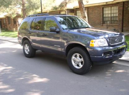

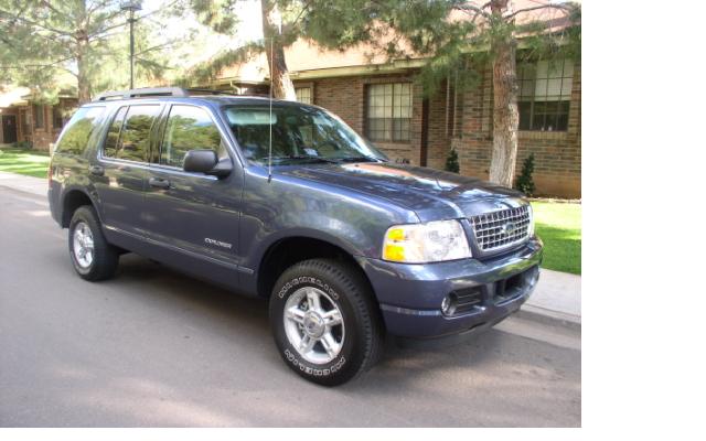

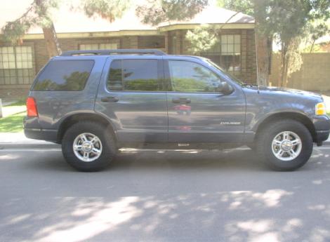

Found a place that would test fit several tires for me. We enden up with a LT265/75R16 Big Foot AT. These fit with very minimal rubbing at full lock. If I back of the steering wheel 1/2 inch they will not rub. My truck would not take anything bigger. Also, I got a matching spare, and that barely fit into the spare tire area.
Before and after shots are attached.

That looks pretty damn good! :)
wow looks a lot better...... havent see n you on the site in awhile... you were the same enterprize that had the explorer FAQ from way back in the day right?
