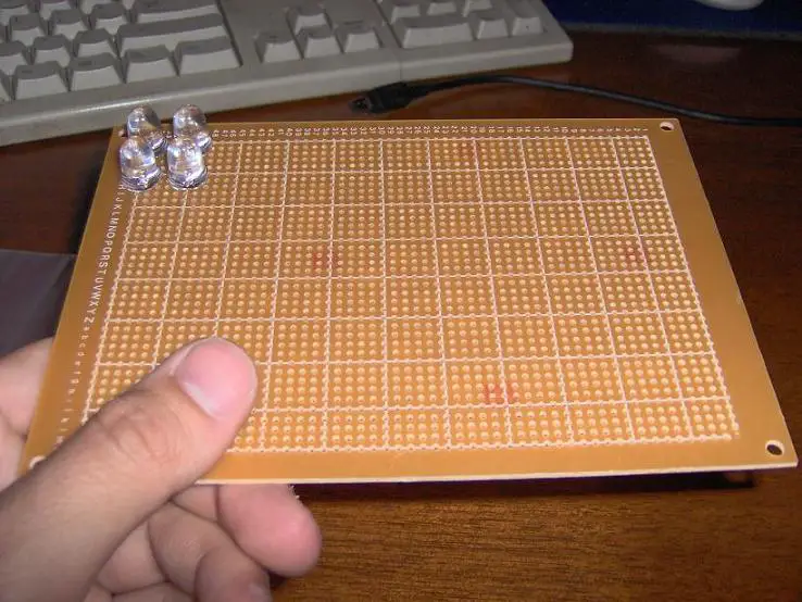

I originally bought these LEDs to make some custom fog lights buy bought HIDs instead So I was bored tonight and came up with these. These LEDs are 10mm 10000mcd hyper whites. Anyway, these took me about two hours tonight and I wanted to show them off. THey are alot brighter than the camera makes them out to be because of the light compensation. Now I just have to make them fit in my mirrors. The soldering job is terrible because I had no flux, bot oh well--it will be fine with the little current they draw. I have about 1000 of these and I am now working on some 6x9 driving lights.

Yeah, it is going to take some work to fit them in there. I may have to trim the boards a little. The thing about LEDs when you get the mcd this high--they are extremely directional. I hope the lenses disperse the light.

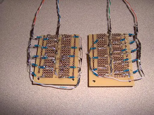

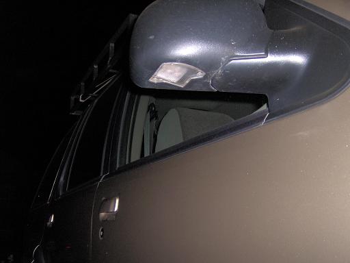

well, I decided to change the design of the whole thing. The originals would fit fine, but would be open to where the mirror movement is. I built these to fit into the stock light enclosure. I dropped the number of the LEDs to 8 each. I was able fo fit them where the stock bulb was and sealed them back up with butylene.

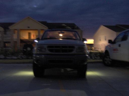

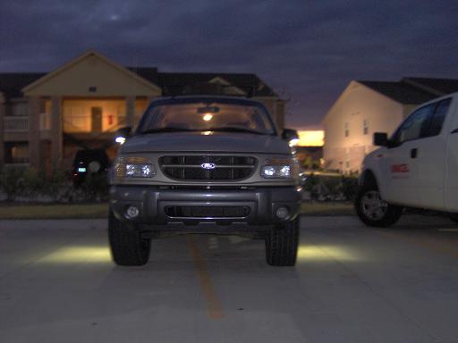

more pics.... The lights are alot more blue white than pictures make them look.

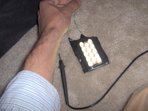

I planned on building offroad lights with about 500 LEDs each. I had lost interest interest in the project until yesterday. Now I have started back on them. These wont quite have 500-and are only 4x6, but should be piss bright.
