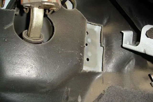

Well I got it fixed but took some pics so other know what to look for.
Here you can see the holes where the spot welds were. they just ripped right through the fire wall, which by the way is paper thin :rolleyes:
