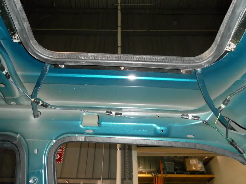

Here is what a first gen sunroof looks like guys. The headliner is not that hard to remove. I had to R&R my sunroof to replace the butyl tape sealant between the sunroof and the roof. It had been leaking for some time.
