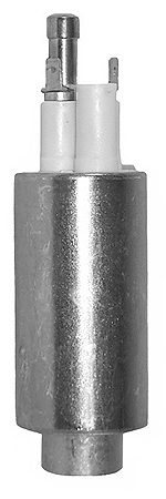

A Motorcraft Fuel pump can be had for around $275- the thing is I read that it must be put in very carefully as it contains a float that can damage easily.
Once the tank is dropped and the fuel pump removed the job is a piece of cake. IMO installing a new pump is the easiest part of the job (dropping the tank , removing the fuel lines are the hardest parts. The float can be damaged, but it is very unlikely unless your re-using the sending unit and just replacing the pump. Replacing just the pump requies you to slightly manhandle the sending unit assembly to remove the old pump and install the new which could cause problems with the float. I would recommend rempacing the whole assembly at the same time since its cheap $$ for a part that may fail down the road (The tubes are zinc plated steel (as opposed to the stainless steel OEM lines on the vehicle) and will rust out over time).
The fuel pump (englarged pic on the left) is $62 and the whole assembly (right) ranges from $115 - $152 from Advanced Auto Parts
