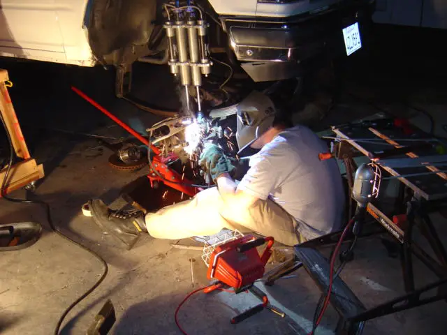

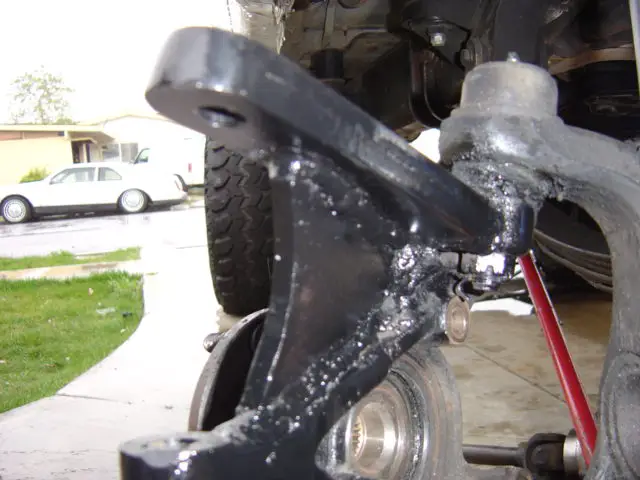

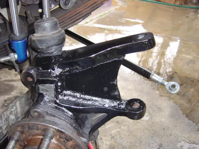

I bought some chromoly tube. Used 1 1/4 inch tube with a .120 wall thinckness. Cut it to length and welded on chromoly heim joint ends. That was all easy. The hardest part was modifying the stock knuckle. So we cut two pices of steel. The first was the new piece that would connect the new drag link. I cut that out of 3/4" steel and my freind "the weldor" welded it for me since it is a 'cast' knuckle. (didnt want to die if it broke:) ) Anyway the second pice was cut out of 3/8" steel that was placed vertically under the 3/4 inch piece like a "web" to provide strength.

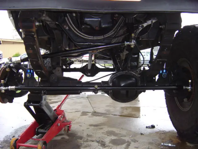

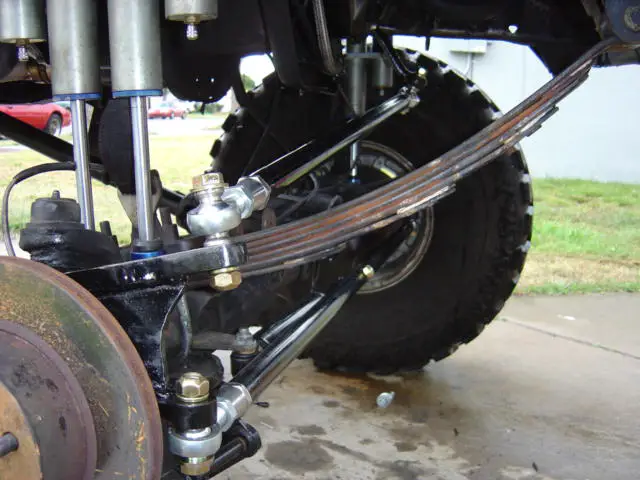

here is what it all looked like finished..... note that the drag link now goes above the leaf and is very much closer to level. The result was incredible!! No bump steer and finally a nice tight steering feel with responsiveness!!!!! worked awesome!!! Total cost for tubing, heim ends, and bolts was right at about 300 bucks. (knuckle was done by friend free of charge). (Labor was done by me free) I also got about a $70.00 savings on the heim joints thanks to my friend. That helped alot....

The original steering was scary! Glad you got it fixed now. Are the bolts tight? there is no thread showing through the opposite site of the nuts.
Heh, my jack works....
I got bolts just the right length so they are actually flush with the nut end. Yes they are tight and perfect length. All grade 8. I got lockwashers on there and locking nuts.... they arent going anywhere. In one pic you can see that the bolt doesent quite clear all the way through the nut, that is only because there where extra washers on there and it was just put on for "mock" purposes.

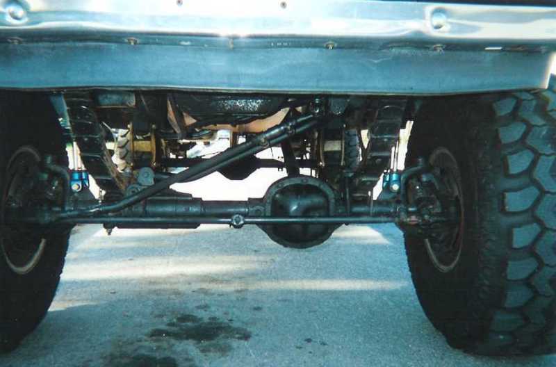

Why not flip the drag link so it runs on top instead of the bottom? You would get a few more inches of clearance. :)
Thats what i did when i went crossover on my turd.y

I realize the options for high steer on a D30 are slim and/or expensive, but you are seriously pushing the limits Chief. I have broken a D30 knuckle with steering mounted to the stock location, and Rick broke his D44 knuckle that was welded up similar to yours. I'd hate to see you break that on the trail and leave you stranded.
For the amount of money you spent you could have bought the nice kit from www.mountainoffroad.com
I have seen to many of those that you made break.

I was going to flip the drag link but the steering stabalizer wouldnt fit that way. I looked into mounting it in different ways and clearance between the axle disconnect housing and the diff cover were just not allowing a very good way. So I kept it under and it is clean that way. There is no issue with clearance its very high up and the stabalizer or axle housing would hit something first.

Trckmagik: Well there is no gaurauntee that would fit my truck because obvioulsy it isnt a jeep. Also I spent 300 bucks and that kit is about 500 bucks. The other thing is, I wonder if that kit includes chromoly for the rod and chromoly heim ends.
I understand the concerns though, I have the same ones, but hopefully I dont have an issue. we shall see. It held up this year. hopefully I will get the dana 44 before I have a breakage issue...
