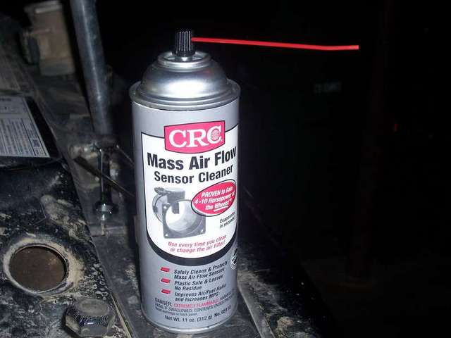

i went to schucks auto, but any auto parts store will do, and i picked up some maf cleaner, sensitive electronics cleaner will work too.
Next i unbolted my maf and placed it on the ground with the top being the filter side, the side on the ground is the throttle body side
Next, hold can about a foot away, and spray in pulses, about 15.. let dry, it should fairly quick because of the alcohol in it, but give it some time, a few minutes.
Use this wait period to clean the inside walls, i put that spray on a cloth and wiped it out, be sure not to go near the actual adapter, those filaments are easy to destroy.
After you are done cleaning, bolt back in. Take a drive around the block.... i always do!
