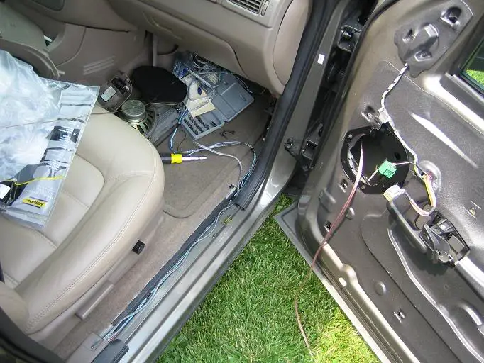

Next I pulled the front door panels and took out the stock speakers. I ran 16ga speaker wire from the door through the rubber boots, and back under the door sills to the amp. This avoided the need to splice into any of that thin gauge stock speaker wire.

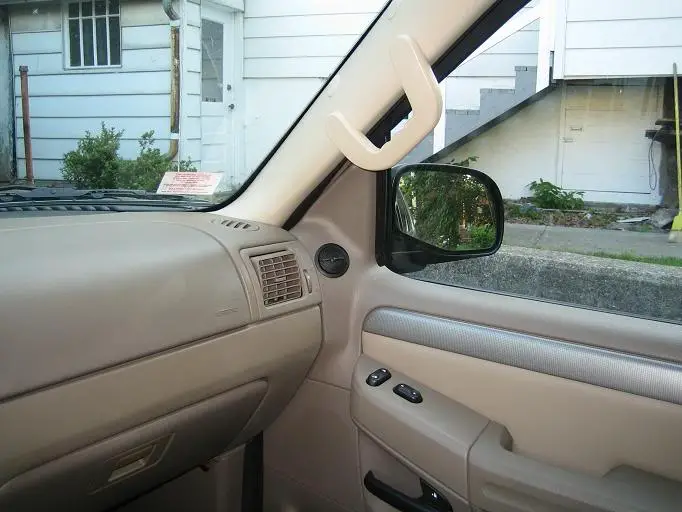

I custom mounted the tweeters up on the top of the door panels using the supplied flush-mount cups. A dremel sanding drum made quick work of the door to provide the clearance hole for the tweeter cups. The quality of the clamping system from Boston was very good and the end result is an almost factory looking tweeter install.

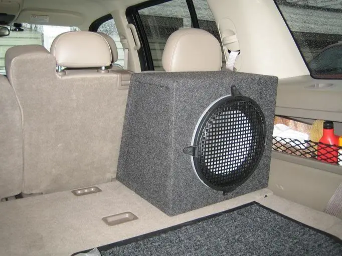

The Infinity Perfect 12.1 went into a sealed Scosche EFX sealed box along with a grill for protection from cargo. I used 12 ga wire both inside and outside the box for maximum current flow. It is hooked to the bridged rear channels of my amp for 278 watts RMS. Each of the front speakers is getting 111 watts RMS.

I recently install some 6.5 comps in my explorer and made custom MDF baffles but im having some clearance problem with my passangers side door panel. I also mounted my tweets in almost the same spot and find they sound better with the tweeter @ -3db.

Thanks for the pics! Do you have any pictures of your amp installed? I think you said you have it on the floor in your 3rd row....
Ok here ya go:
The slant on the back of the sub box matches up perfectly to the rear seat.
Ignore the random black wire that is my CB antenna, and the blue/white twisted wire that is just hanging out there because I had to move everything around to take the pic. The amp is right under the sub in the first pic when everything is packed up.
You can also see where I am getting the ground for the amp from the seat mount bolt.
Jason
nice work, i'm getting ready to install my alumapro's in the next couple of weeks, but i'm deadening the doors at the same time.
how did you get the speaker wire through? i tried and tried, and eventually said screw it and spliced the factory wiring, right now im using my little crossfire on the front factory speakers and deck power for the rears.
Getting the new wire through the boots was not as bad as I expected. The trick was to separate the boot from the main chassis of the car. At the vehicle end of the boot the rubber is pretty thick and has a groove in it where it fits into the hole in the body. So if you squeeze it and work it for a while it is possible to get it out of the body so that the end of it is flopping free. Now its simple to fish the new speaker wire through the boot first, and then through the hole in the body down through the kick panel area. Remove the plastic kick panel cover and you will be able to find the wire you just pushed through. Now, the drivers side was a bit more difficult since the whole E-brake mechanism bolts on like right where the speaker wire comes into the car. However, if you take a wire coat hangar and use it as a snake it is possible to fish it through until you see it, then just tape the new speaker wire on and pull.
I just zip tied the stock speaker wire clips back to themselves inside the door so that if I ever sell the vehicle I can remove my components and put the stock speakers back in. Of course I would have to find some cheap tweets to fill the holes too.
You did a great job, and the install looks flawless. I would have mounted 6.5 components over my 5x7 component set, if I knew about those adaptor plates. You might as well replace the rear factory speakers. Good work!
