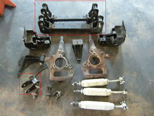

Here is a picture of the kit. What I have to have is the ends on the bars in the top box. I also need a diff drop bracket like is in the lower box. What I thought about was instead of making the bend like the lower piece, cutting two separate pieces, overlapping them to achieve the same effect. Would that work?

This is a little hard for me to picture in my head - perhaps a rough diagram or two might help :)
Ok, don't make fun of my drawing! The left bracket is how the superlift drop bracket is made. The black bar is a pipe that connects the two halves. The right drawing is how I want to recreate the bracket. By over lapping the two pieces I get the same effect, without trying to make precision bends. I have brackets to work from as far as design. I believe it will work as long as the overlapped section dosent interfere with the parts going together. Is that clearer?
Sounds like itll work :D
hehe itll definitely work .. what i would focus on are the suspension parts/brackets <-- those are the ones that are going to see the most abuse and stress. ;)

He has everything he needs to bend them. Just clamp it down on something (not burnable) where you need to bend it. A vice works too. Heat it up red hot with your torch and smack it with a hammer. It doesn't need to be a big hammer or a hard hit either. Let it cool, turn it over, and slide to the next bend. Do not quench it in water to cool it regardless of what those dummies on TV do.
We did that all the time in a steel shop when we didn't want to walk all the way down to the press break to use it.
If they are like the ones in the above picture, they don't need much of a bend.
