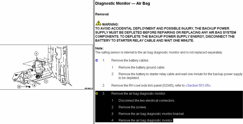

My airbag light is blinking a 2-3 (Memory Clear Circuit Improperly Grounded). Where is the module located so I can check its' ground?
The diagnostic module is in the right hand kick panel behind the trim piece.
