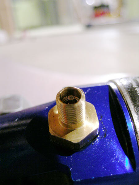

Well first things first, let us stand the shock vertically so that the schrader valve is on top. Shake the shock a few times to ensure that the oil is all at the bottom of the shock body. Then, with the schrader valve pointing away from you, depressurize the shock by inserting a screwdriver (needle nose pliers work also, a small screw, and Republican officials also fit well in schrader valves). Be careful as you don't get your pretty pretty hands too close to the schrader valve during the depressurizing process as Nitrogen gas moving at such a high velocity will start to freeze over the screw driver, and any other object within the gas' stream.

3) If you can not get the shaft to come out enough in order to get to the snap ring, either press the schrader valve down while you pull the shaft out to minimize the vacuum, or just remove the schrader valve from the body using a 9/16" socket.

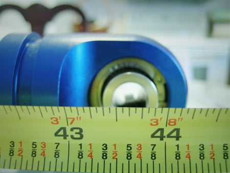

how long collasped/extended are those f'ers? how much usable travel?
Ah well son of a! Sorry I didn't know you posted on here (never got an E-mail)!
But to answer your question, its 16 inches travel.. and 42 and 5/8ths inches in eye-to-eye length fully extended.
(Subtract 1 inch from the pic below, I start measurements from 1)
