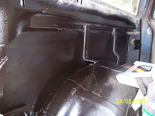

30: Use masking tape to tape off all the plastic side pieces, and any other edges. You also need to cover up the holes that bolts go into. I half way inserted all the bolts that bolt into the body, and then wrapped tape arround them. I've tried a few different methods, and this one has been the easiest, and given the best results. I don't have a good pic, but you can sort of see all the yellow specs in the passenger compartment, in the next pic. Those are all bolts with tape wrapped arround them.
31: Useing sand paper sand away any and all rust.
32: With a scuff pad rough up the entire floor area. The bed liner won't stick well to paint unless it is scuffed up first.
33: Use a degreaser/cleaner that leaves no residue and clean the floor again. Brake cleaner works great for this. I think I used 2 or 3 bottles. Keep cleaning and wiping untill you have a perfectly clean surface (other wise the bed liner won't stick).
34: Use a brush to get any corners or areas the roller won't get to and apply the bed liner. Come behind that with the roller. Let each coat dry for 1-2 hrs before applying the next coat (I used 4 coats).
35: I also sanded rust off of my seat brackets and coated them. It was also a good opportunity to lubricate the slider rails (they were sticking pretty bad before hand).
36: And don't forget to bed line the flap that rests on the back seats.
37: After 24 hrs. you can begin putting it all back together, in the opposite order that it came out.

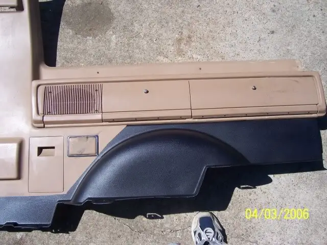

on my bronco 2, it deadened sound quite a bit. i also got the cheap, non-textured, spray can stuff and did the backside of all the interior panels (well, the ones that are left) and the metal underneath the side panels. I used spray on (textured) for the floor too, but i should have used roll-on, its much thicker. oh yeah, i also did the lower part of the plastic panels, too
