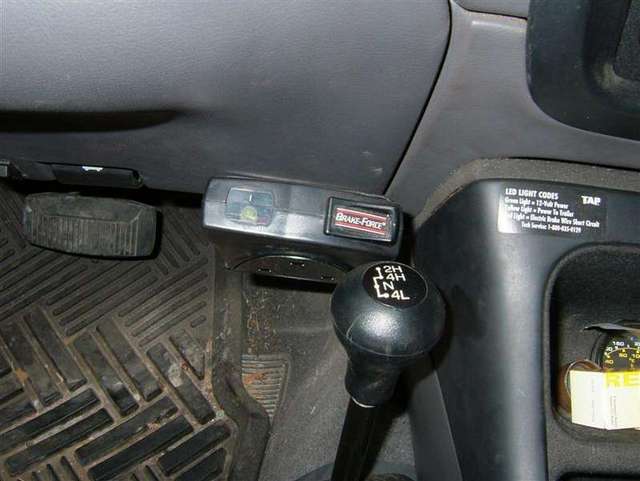

I use a time delay brake controller in my truck. It is a basic controller, no frills.
I mounted it to the dash, near the console. It doesn't interfere when I am driving and works OK. People swear by other more expensive, Proportional controllers, but I personally couldn't justify the cost for no more often than I tow.
Picture of my install-

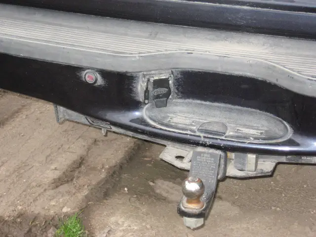

I did a custom install for my 7 pin RV style plug, I didn't want it hanging down below my hitch or bumper since I use my truck for offroading. I cut a hole in my bumper and mounted it to the side.
Stealing my idea huh? Where's my credit?
I did mine back in January 2004. For the same reasons as you. I felt, if I ever offroaded this truck I didn't want it hanging down. Looks much neater in the bumper. Sure was fun drilling the hole.

what did you cut your hole with?
I marked out my line, then cut with a die grinder and cut off wheel. Then used a smaller stone and file to make the plug fit.
Weird how yours looks just like mine- it just worked out just right that way for me.

I bought one of those drill bits to make holes in doors for door knobs. I think it was the 2" one.

Bringing this back from the dead. Sweet set up. I just rewired my 6-pin plug, but never liked how it hung down. I think I have a project in the future!

I really like mine still to this day- no clearance issues, if it had been hanging down, I'd pulled it off many times by now.
One tip- depending on how you cut your hole- remove any plastic nearby. When I cut my hole, I used a die grinder and cut off wheel. The hot metal I cut embedded in the plastic and subsequently rusted.

Thanks for the tip. I realized I don't have access to an outdoor plug though. I don't think my 14V Cordless drill could hack it. Hmmmm , I think the maintenance area has an outlet outside. With what I'm paying for rent, I think they owe me a kW or two.

2008 Explorer trailer brake controller pigtail location
I have a 2008 Limited. After a lot of looking for the trailer brake controller connector, I had someone with a smaller head get in there and find it for me. I posted a few pix here.
https://picasaweb.google.com/1039561...eat=directlink
I couldn't figure out how to do attachments in the forum. Hopefully they'll help a few folks out. I'll keep the link live for a while. Perhaps someone can post them here on the forum for others to use.
Hope it helps.

Looks like the orientation of the socket can be different year-to-year, but that's the same location as mine, and I think the same gray color.
