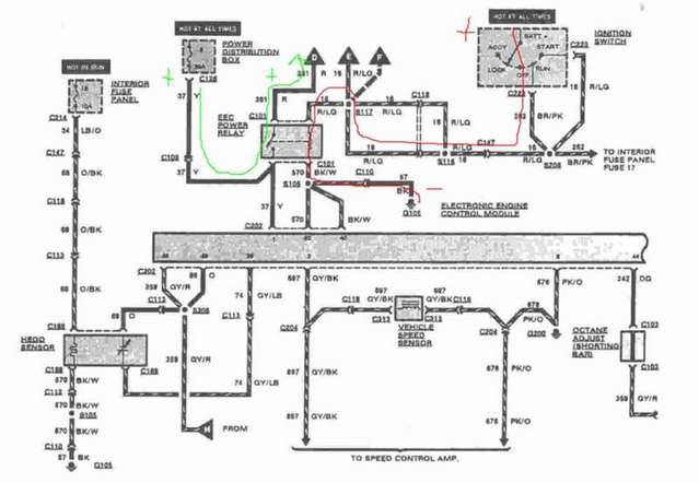

I have a well maintained 94 Explorer with 160,000 miles.
The truck runs great but simply stopped running while backing out of the garage (it could have been much worse).
When I first turn on the ignition you typically hear the fuel pump pressurize the system, but it no longer does.
Using this site I dropped the tank and replaced the fuel pump. Not a problem but it still won’t start and the new pump does not energize with the ignition on.
I had already checked the fuses and the inertia switch, but all check fine. I then scrapped away the insulation of the hot wire at the pump and get no voltage with the key on.
In fact, I checked and get no voltage at the inertia switch with the key on.
Is this a computer controlled signal?
