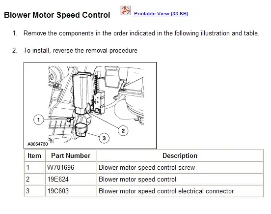

OK, with the DATC system the fan speed is controlled by, ta da, the Blower Motor Speed Control. Drop the glove box down out of the way and look slightly left.
[IMG][/IMG]
If your bro puts in a new one and it doesn't last very long it's probably because the blower motor itself is out of spec though.

Thank You, Thank You, Thank You !! We'll give that a shot. Finally it's not the dealer or FLAPS saying "here's where it is" and then it's not there. We now have another place to look. Thanks!

Well, that didn't do it. Replaced the blower motor speed control, and it's still only blowing on high. We're going to try un-hooking it, un-hook the battery, then hook it all up again and see if that works... kinda like a re-boot.

Sorry to hear it didn't work for you. That's usually the culprit. I suggest you get it properly diagnosed rather than throw more parts at it now. My hunch is it's probably the DATC module that is bad, but they are expensive. Here's a link for what they cost from directfordparts:

I wanted to re-post and thank you. I FINALLY got a parts guy who took the trouble to use my Vin #'s to get the right part. Some models use the Blower Resistor and some use the Blower Motor Speed Control unit, just like you said. Mine needed the Speed Control Unit you have pictured. I exchanged the blower resistor, which I was sold originally, for the speed control unit and it was a one screw r&r install. The fan now works when it should, not ON constantly. The unit was only $55.
Thanks for taking the time to post. For anyone reading this in the future, give the parts guy your last 8 digits of your vin # so he can get you the right part.
