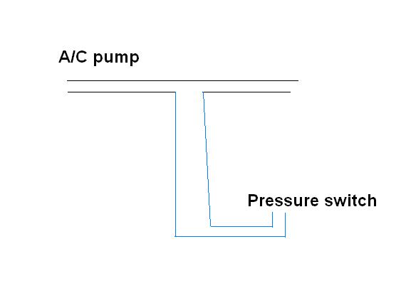

I spliced in my pressure switch inline with the factory wiring to the pump.
Also over by your airbox there is a pressure switch for the factory A/C that need to be spliced together to by pass the switch.

I got a couple of questions for those of you who know. I picked up a Furnas pressure switch with an unloader valve. It was 6 places to hook up wire. 2 say motor, 2 say line and 2 say ground. I am just going to hook in a whole new switch for the system so How will I do this? And the other question is, can I just cap off the unloader valve and not use it or is there a use for this valve?
o and is the intake side of the compressor the right or the left when looking at the front of the grill? I figured th intake was on the right going up to the grill and the output was on the left going to the firewall.
The pressure switch is a double pole, single throw switch. The 2 which say line are the parts where the power would connect to. The part which says motor go to the electric compressor, or in this case the electric clutch. You could cap off the unloader unless you want to install a check valve with the port for the unloader. The ground is just the vehicle ground which could either be connected or left alone.
