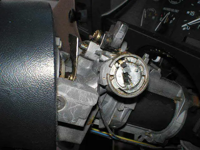

Someone tried to steal my '91 XLT and Broke the Ignition switich. It looks like they jamed a screw drive into the door lock to gain access, pryed off the chrome thumb ring around the ignition lock(it's was laying on the floor) then stuck the screw into the switch to try to start it! :(
What do I need to do to replace the ignition switch? I can't turn the switch to ON w/ the key to do a typical removal. Is the chrome thumb ring still usable? Any help appreciated.

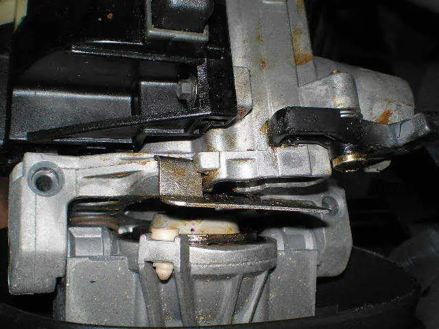

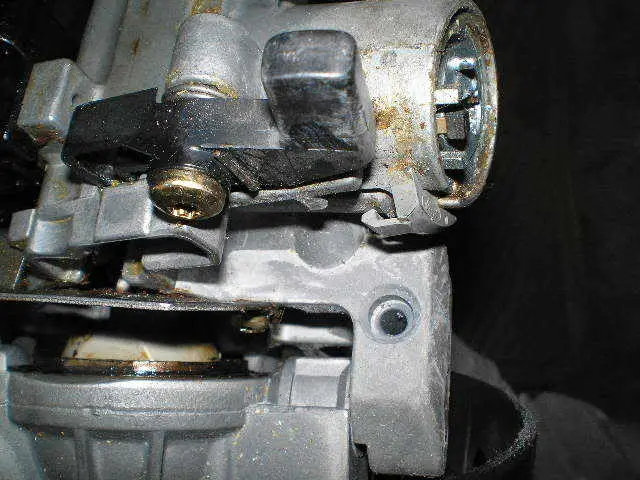

Here are photos I took, any help? Where is the release located?
On mine I had to take that plastic shroud off. & to do that I had to pull the steering wheel. The hole is located at the bottom of the column under that shroud.
Altaman, maybe these pictures will help...

Gloomis, great pics, thanks a bunch
Well, I spent 1 1/2 hours trying to get it to release. I'm pretty sure I'm in the right spot. A couple of times I felt something push in, I was even able to turn the key a bit to the ON position, but couldn't get the lock out.

The notations by Gloomis on my photos were right-on and should be included in the definative description of where to find the release pin:thumbsup:
After 2 hours of trying to release the lock I had to break down and get locksmith to come out. It turns out the theives had cracked the lock and that's why I couldn't get it out-he had to drill out the lock, did a nice job.
