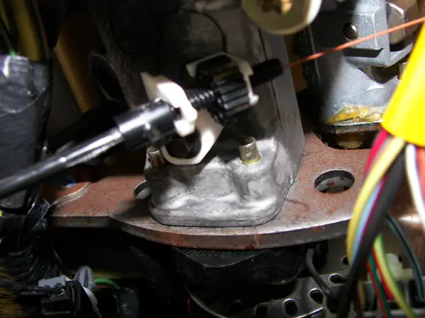

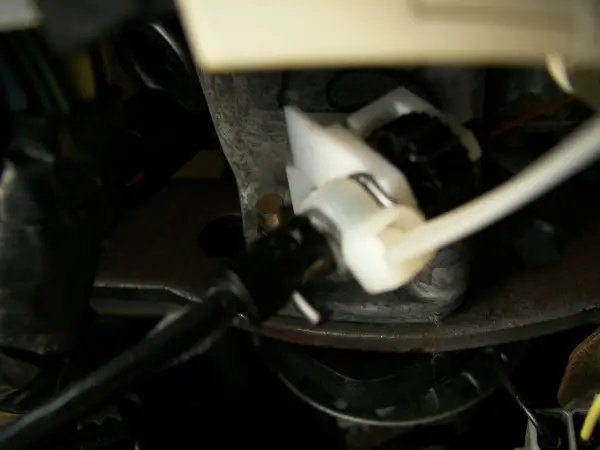

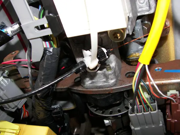

Took some pics:
#1 - What it should look like
#2 - What it looks like broken
#3 - My fix with the wire tie

Pumpkin, thanks for the great pictures. Used them to "fix" my broken shift indicator bracket this afternoon. I used your duct tape then wire tie repair. Took about 45 minutes.
hmmm so that little white bracket thingy that holds the thumbwheel in place is broken. Its the top half of it that is closest to the copper wire in the pics is broken off of the bottom half which lets the thumbwheel go way out. Any ideas on how to patch that?
Your welcome. Pictures do come in handy:thumbsup:
