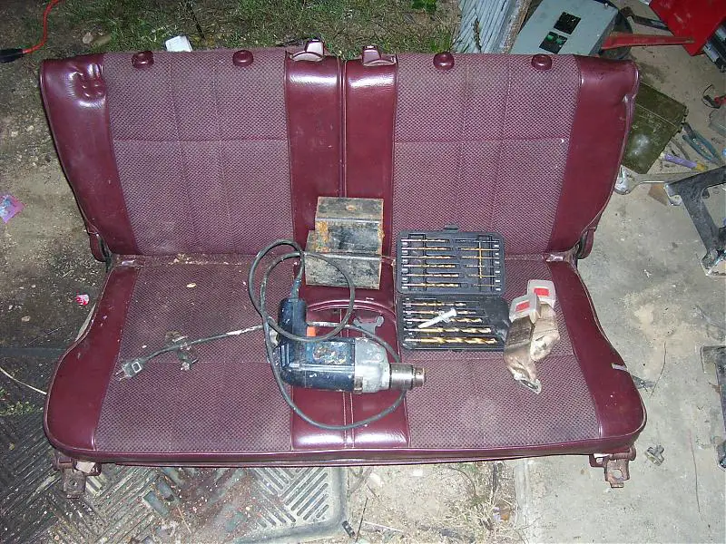

what you will need (for my set up)
1) seat out of a dodge colt vista
2) 40 inches of angle iron
3) seat belt clips from a 84-87 corrolla (nova)
4) 2-4 inch square tubing
5) drill bits
6) wrenches
7) bolts high grade..and 1/8 rounded steel plates

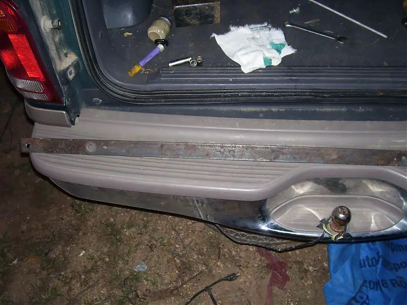

first let down spare tire then

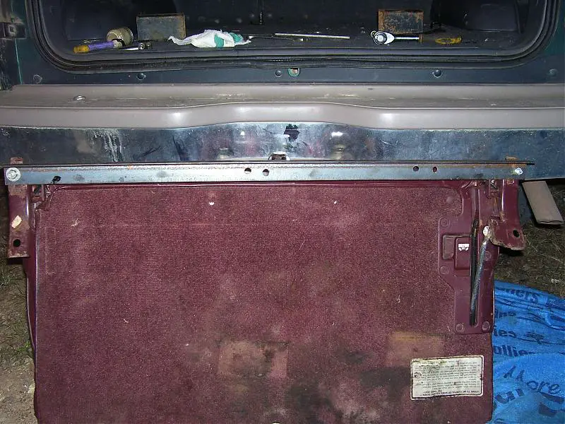

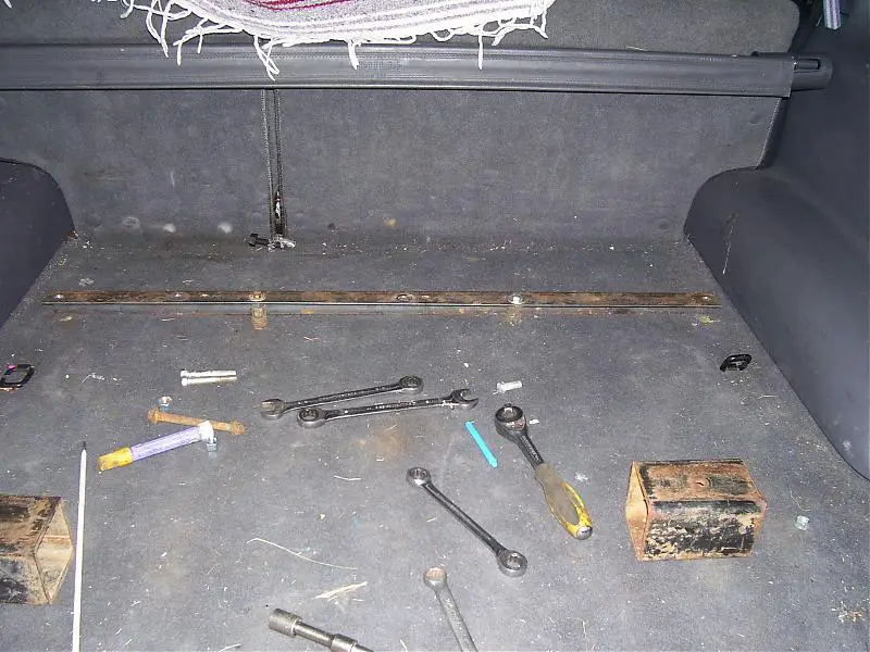

measure across the floor borad of the cargo area to drill the holes for the angle iron,and get them between the frame rails... put bolts in and this is where you will add the 1/8 steel plates under the cargo area facing the ground , measure the seat and drill the holes to attach it to the angle iron...

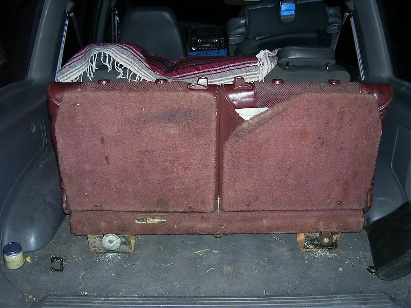

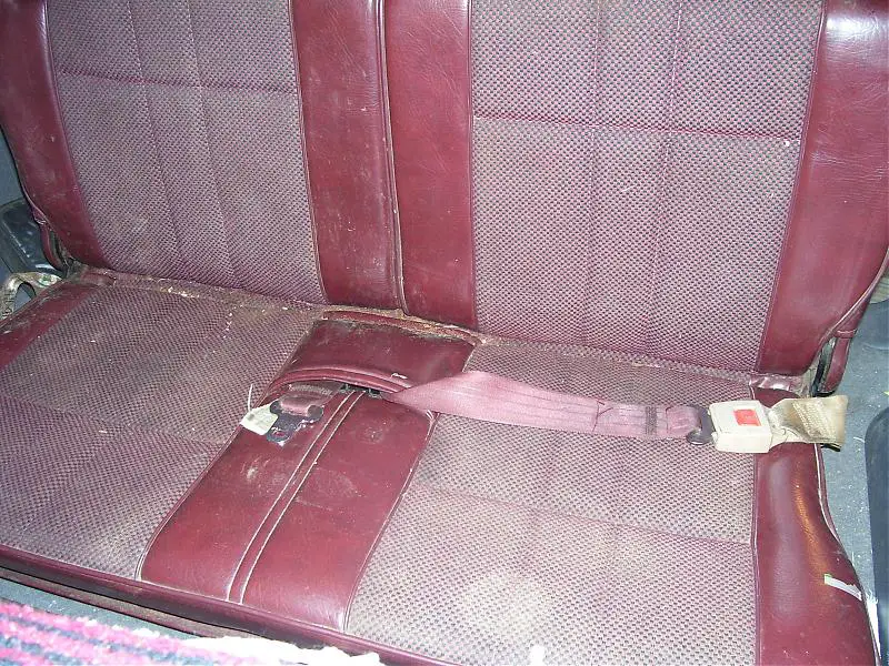

okay angle iron is attached... now get the blocks..if you look close these was easy to attach... watch drilling the left side there is a black box there (antilock??) drill attachthe blocks then the seat to the blocks... for the seat belts you can attach the one part to the floor board also my seat has a spot to attach them to the side (might redo it later) and there you have it!!!! third row and no new payments!!!
