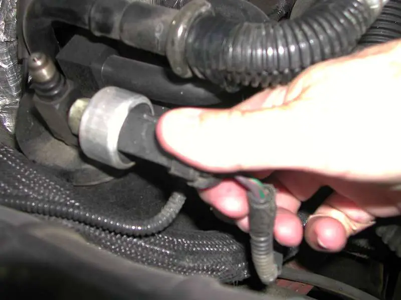

I bought a kit and a Chilton book on the 02 Explorer. The book says that I have to have the clutch engaged at all times to do a refill of freon. To do that, the book states that I need a jumper wire, but it doesn't say how to, or where to connect the wire.
I have managed to get some R134a into the system and I am getting a slight bit of cooling. That took about 15 minutes. With the clutch going on and off every 2 seconds, I can't tell from the guage on the refill connector hose, what the pressure actually is as the guage needle keeps bouncing back and forth each time the clutch cycles on and off. Any suggestions?
Remove the low pressure cycling switch electrical connector from the switch, and insert the jumper wire into the connector to keep the compressor clutch engaged while refilling it with R134A freon.
Do you have any pictures, to make sure I'm working on the correct switch and the correct way to put on the jumper wire. I'm a real novice at this, so I need a step by step explaination, please.

Here are some pictures from Glacier991's photo gallery:

Brooklyn Bay - Thanks so much for the great information on this thread. Question regarding the pictures and the jumper wire. I assume that the wire should go from the positive post to the inside of the disconnected switch, right? If so, does it matter which part of the switch the wire connects to? Any advice on how to connect the jumper wire to the switch? I'm just a little paranoid about blowing something. Thanks!
