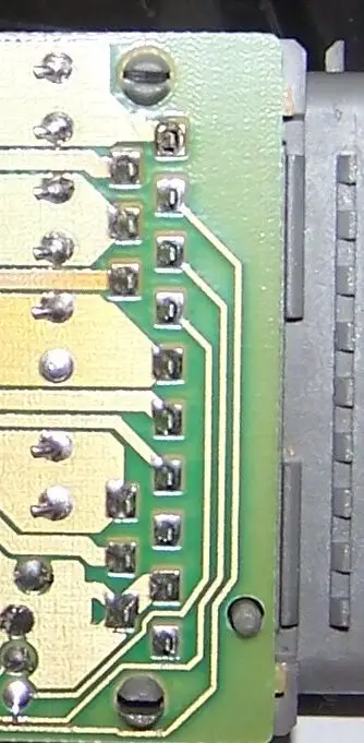

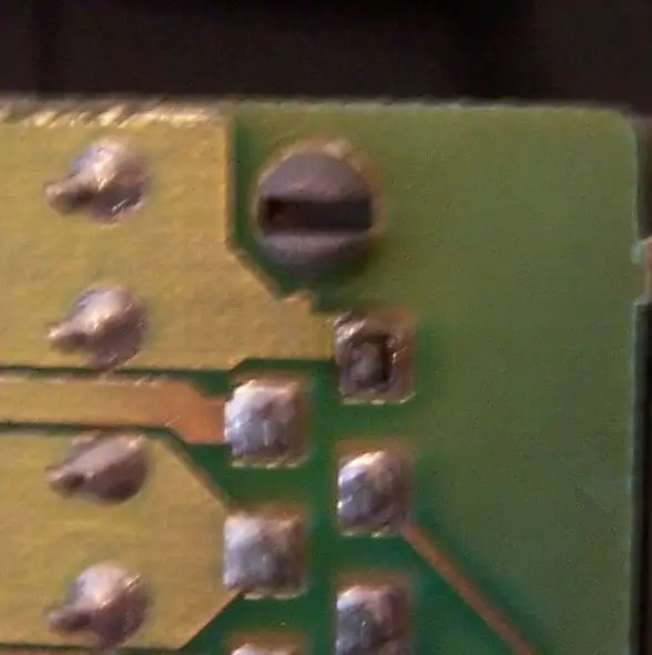

Just wanted to take a moment to say thanks to you guys here. I was able to solve a problem that my sister in law has been fighting for a few months. She was cursed with the Drivers side headlight out. She asked me to take a look and to be honest i just assumed it would be a fuse or a lamp out..i checked both and neither was wrong...i logged in here and in literally 10 minutes...problem answered. I got a spare LOM out of a junker. It was also busted ( suprise suprise) and I fixed it with some solder and then swapped them out. Here are pix of the junked one that went in ( that works now !) and the one that came out...I found it funny that they were not broken in the same spot..LOL
Junked one re-soldered and ready to go in..and all my electrical junk in the background..i have a patient wife LOL
Close up of the same LOM
Closeups of the busted board that came out of her 97 EB Explorer
I hope that these pics can help someone else fix their problems...It feels good to be the hero now and again:salute:

found it and mine was burnt out on one prong:thumbdwn:

Make sure you get a multimeter (best 20 bucks you will ever spend) and check for continuity across all of the printed circuit board leads and the soldered points!

Re-soldered pins # 1 and #11 . Works like a champ ! Thanks to all who posted this info !!
