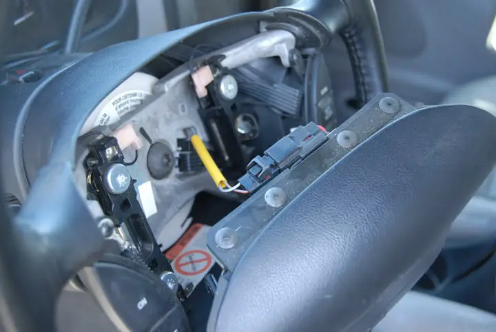

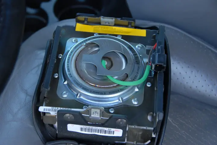

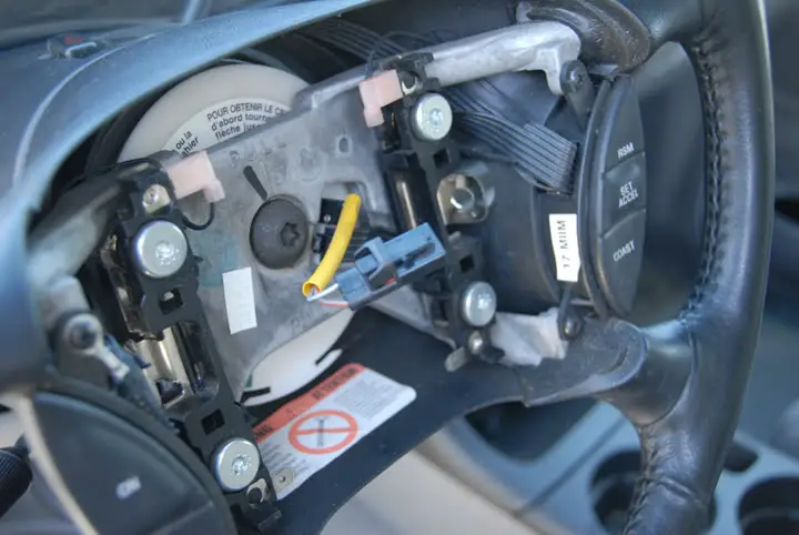

2) I removed the plastic circles from the sides of the wheel and then removed both bolts which frees up the air bag.
3) Now pull the air bag out and disconnect the electrical connector on the back side. And then set the air bag aside in a safe place.

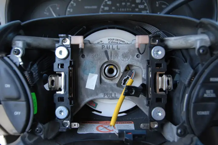

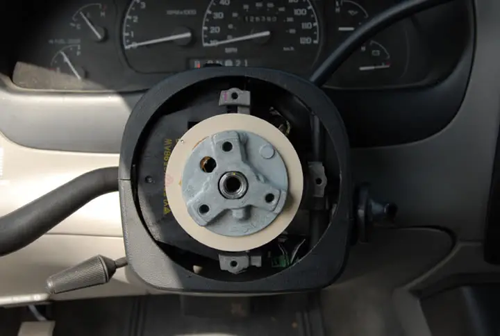

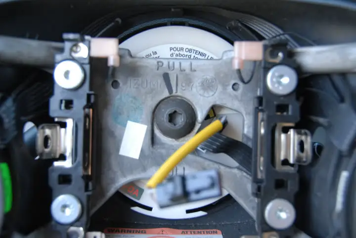

4) Next loosen up the center bolt with a #50 Torx.
5) Then you will need to use a gear puller to pop the steering wheel off the shaft. (seeing that the Explorer doesn't have two holes to use a traditional steering wheel puller). Then disconnect the black electrical connector thats on the right. Now you can pull the wheel off the shaft.

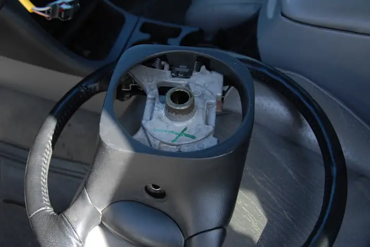

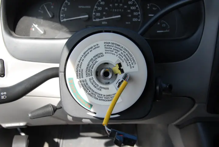

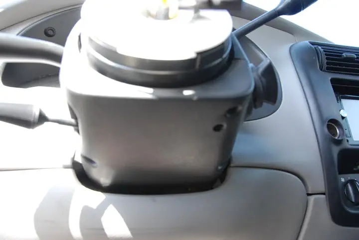

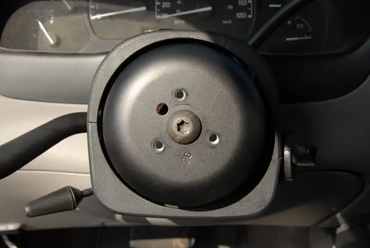

6) Now you will need a phillips and flat head screwdrivers. First start by removing the 3 screws that are located on the bottom of the plastic column.
7) Then there are 3 plastic clips on the backside that hold on the plastic disc. Pop those up and pull that off the shaft as well.
8) Now for this part you decide how to remove the wires to remove the disc from the column. I just cut the wires off but thats because I have plans to rewire the horns a different way.

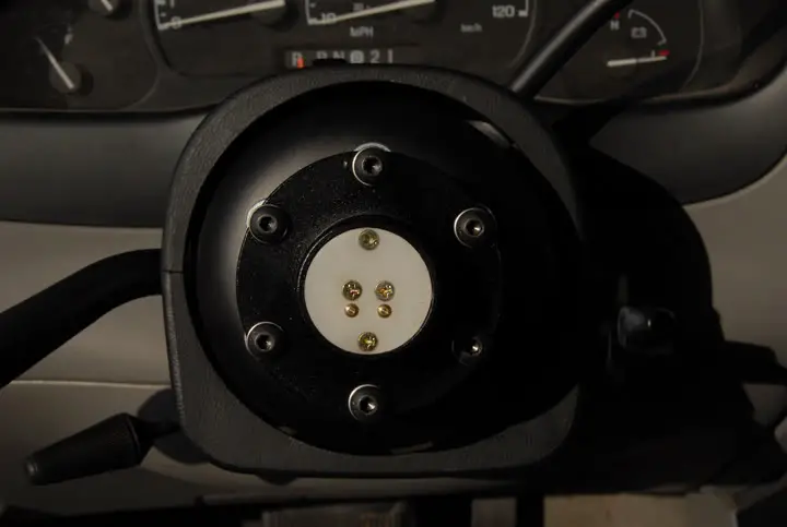

After all this the column should look like this.

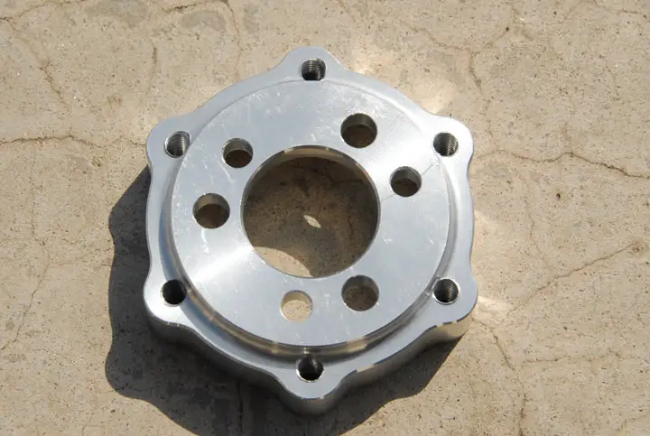

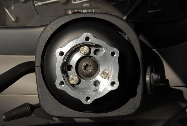

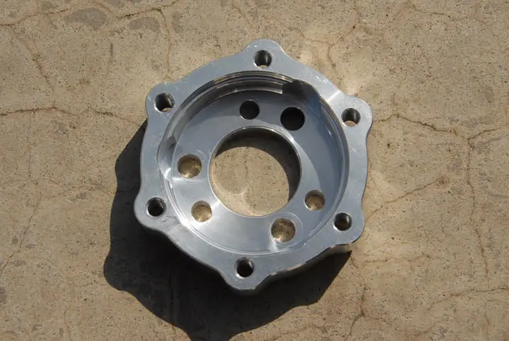

Now this is how I installed my steering wheel and the parts I used. This is where it got tricky and I had to do some fabbing of the billet aluminum adapter I got from Kartek.

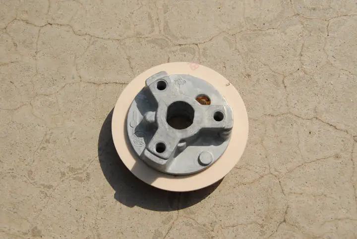

2) Ok if you look at the Grant adapter I used there is a spot that says TOP with an arrow. Now to get this to work on 95-01 Explorers that arrow will need to be pointing to the left not on the top like it should. Now with it pointed to the left slide the adapter onto the shaft.
2) Then I took the billet adapter and lined it up to where one of the 6 holes was in line with the yellow dot which is the stock center marker. After that I marked where the 3 bolts should be on the adapter. Then with a good eye and a lot of measuring I marked and drilled 3 new holes so that the wheel would be centered. (The smaller 3 holes are the ones I drilled). (On a side note I also redrilled and retapped the 6 holes to fit a 1/4"-20 bolt due to this being my race truck and the bolts that were given didn't look strong enough).
3) After I was done fabbing the adapter I then went back to the Grant hub and placed the black cover over it. Then I replaced the Torx bolt and tightened and torqued it to specs.
4) Then I bolted on the billet adapter making sure one of the 6 holes was top dead center.

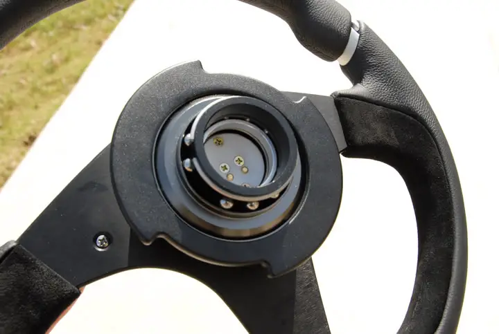

5) Next I bolted the bottom half of my quick release to the billet adapter. (I also had to redrill the 6 holes on this part so I could fit a 1/4" bolt thru).
6) Then I bolted the Momo steering wheel to the top half of the quick release.

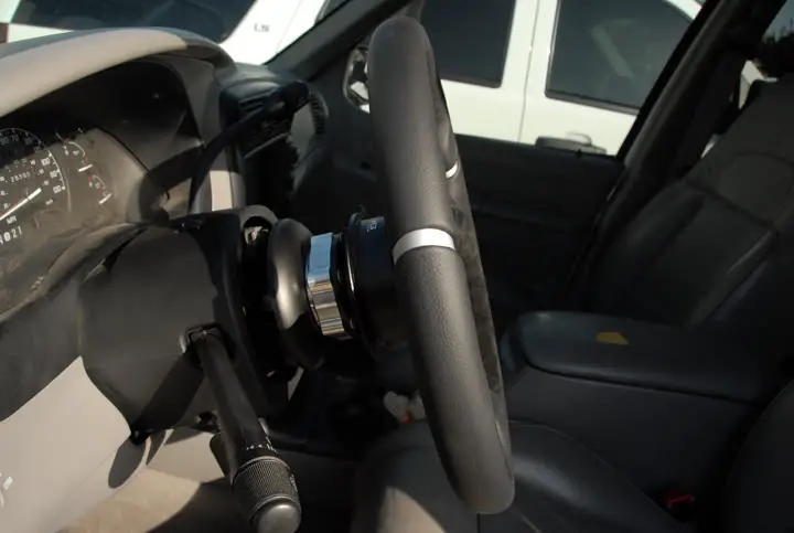

7) Now I just installed the quick releases together and bam its done.

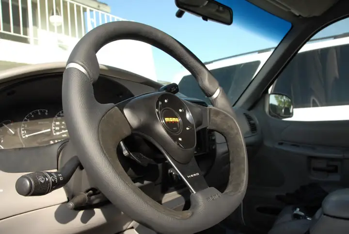

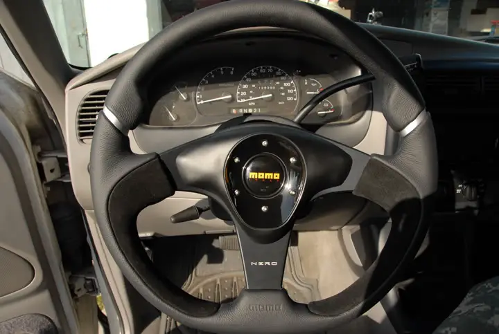

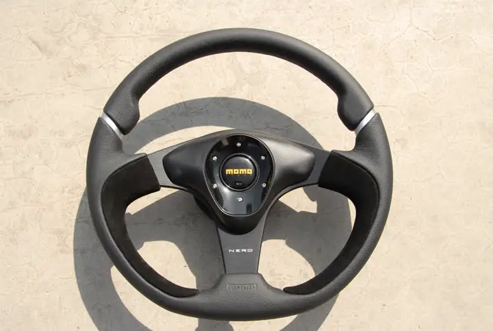

This is what it looks like when I was all done.
Well after a lot of trial and error and a lot of wasted money in trying different parts and trying to mod parts to fit. That was the final result. I am very happy on how it turned out.
