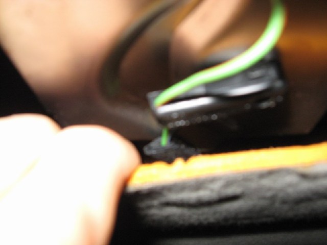

There is an 'always on' source at the front and middle dome lights to provide power to the map lights at any time. This wire is Green/Orange, and is the same front and middle. The black piece to the right is this connection

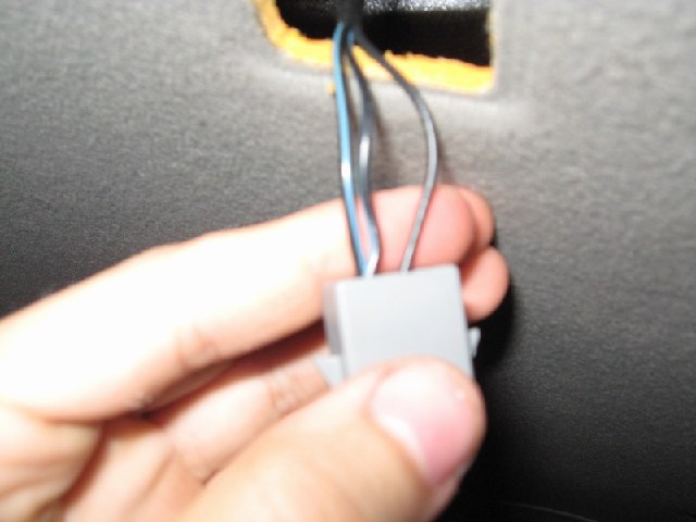

This is the connection to the cargo light. It has 3 wires, two Black/Blue connected together at the harness, and a Black (Ground)

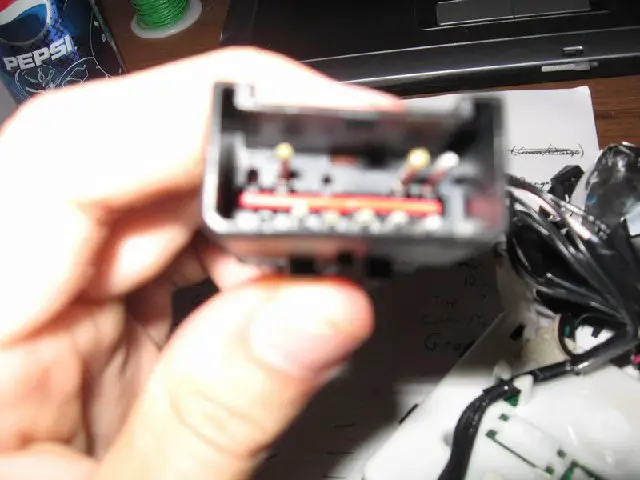

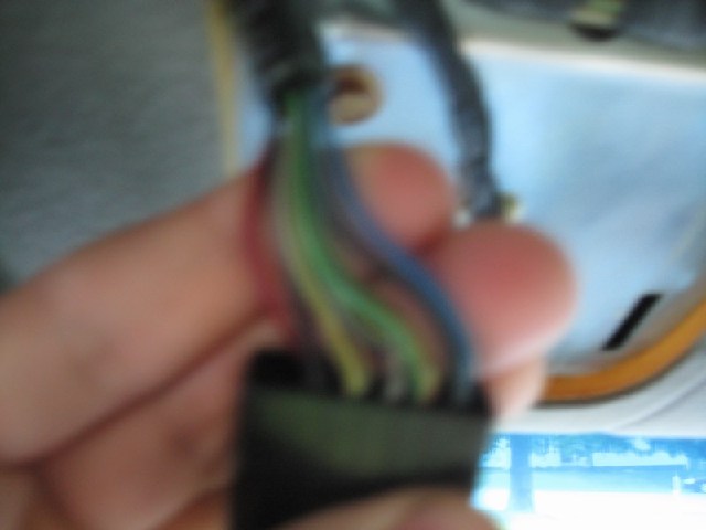

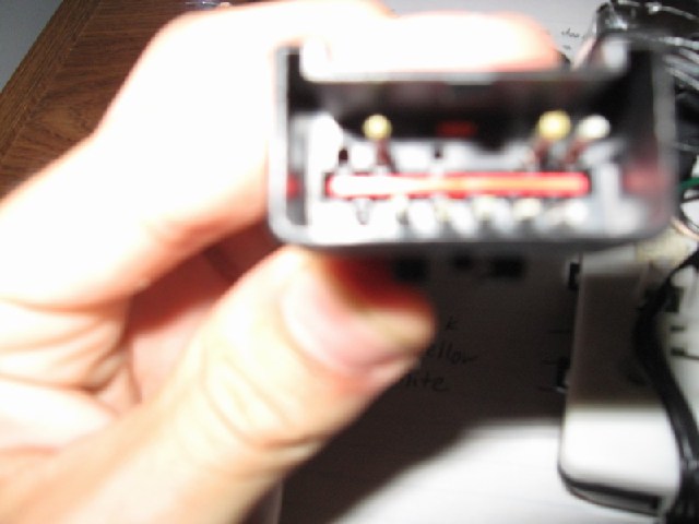

I notice it was connected via a wire harness. I pulled apart the connector and checked it out. It is a 10 pin connector, but only has 8 actual connections in it.

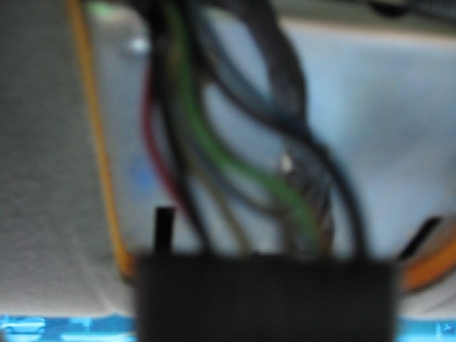

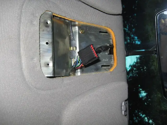

This is the harness that is in the roof.

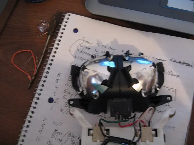

The pin numbers are labeled inside of the this harness that is connected to the map lights/temp. gauge.
Pin 1 is at the bottom left.
Pin 6 is bottom right.
Pin 7 is top left.
Pin 10 is top right.
The wire colors, pin numbers, and functions are as follows
Pin 1 - No Connection
Pin 2 - Black - Ground
Pin 3 - Gray/Yellow - Temperature gauge/Compass power supply
Pin 4 - Gray/Black - I think this is to the temp. gauge, but i could not discern any effects through testing it.
Pin 5 - Green/Orange - 12V supply to map lights, always on
Pin 6 - Black/Blue - Supply for lights from dimmer switch
Pin 7 - No Connection
Pin 8 - Red/Black - Again I think this is for temp but not sure
Pin 9 - Blue/Yellow - This one is temperature for sure. I was able to change the display by applying differing DC voltages
Pin 10 - Blue/White - Again I think this is for temp but not sure

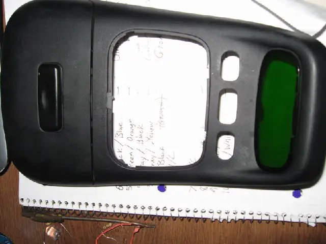

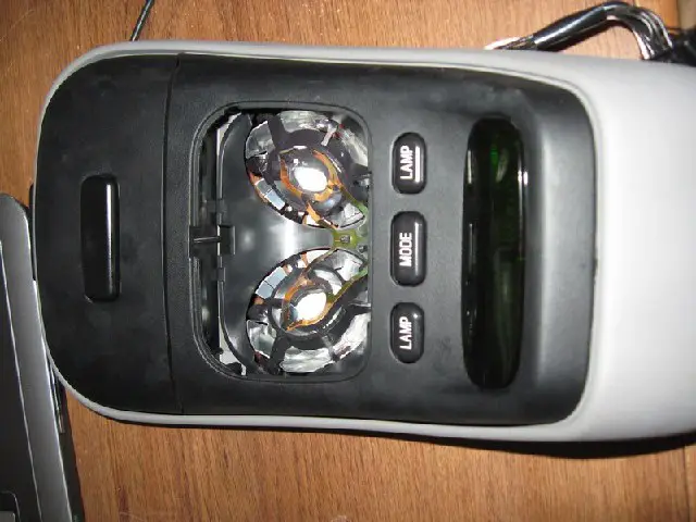

This is the light/compass assembly after removal from the roof. All you have to do to take it off is remove the 2 phillips screws that are inside the garage door opener compartment and pull it off. Don't be scared to give it a little force when taking it off. Just don't try to rip the harness out of the roof in the process ;)

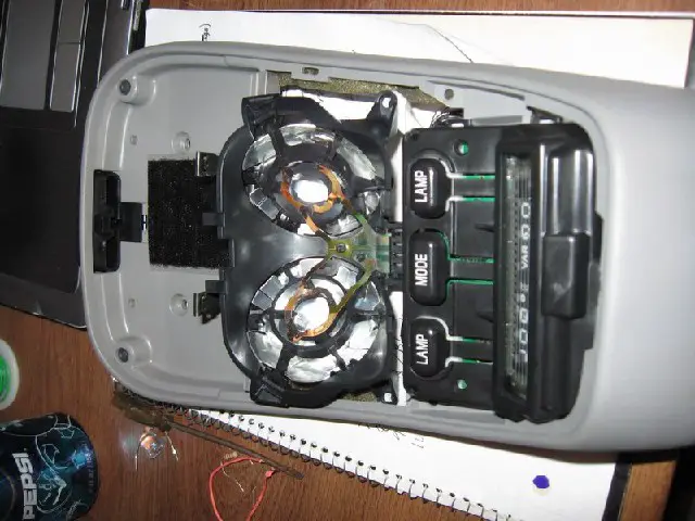

The underside of the assembly. I has several torx screws in it. You need to remove these (7) to remove the map lights and compass from the housing.
This is the cover of the housing. Notice the green plastic cover that goes over the compass/temp gauge. Color change anyone? :D To get this off, you just have to open the garage door opener compartment and pull down on it. It should pop right off.
What it looks like after the removal of the cover. You have to pull them out this way and not through the back

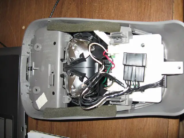

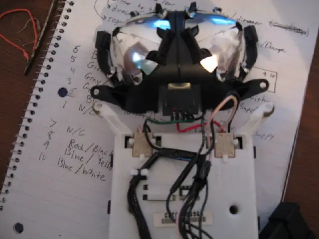

This is the back side of the map light/compass assembly. The 2 beige little blocks are the switches to the lights. Exactly opposite to them are the buttons that say LAMP. The white wire going into each one is the wire from the dimmer switch. The red/green wires are the ones from the constant 12V source. The black is the ground wire. I will most likely be doing some wiring modifications to this, but I have yet to make any diagrams. The rest of the wires go into the temp/compass circuit.

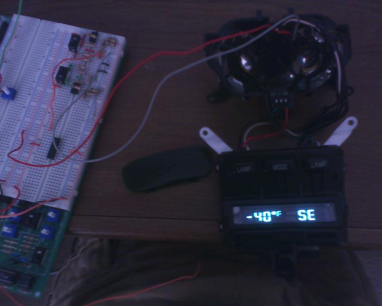

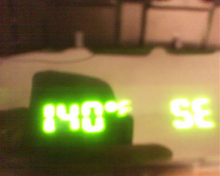

This is the maximum temperature that the gauge will read. I applied a voltage to Pin 9 to achieve this output.
The lowest temperature is -40 which can be achieved by not applying any voltage. This also shows the actual color of the display. It is a light bluish-green/cyan color, and is a lot brighter without the cover.
