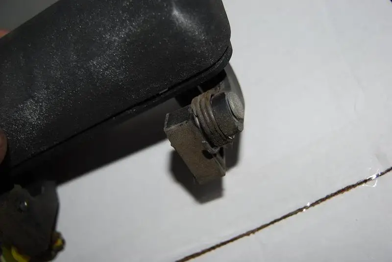

I finally got around to fixing my floppy door handles.
Pretty easy to do.
Removed the inner door skin and swap them out. I spent more time removing the stupid rivets that Ford used then anything else.
These...
I used a punch to knock the centers out and then a pair of pliers to break off the back of the rivets. You could drill them as well I suppose.
New and old side by side.
Can you see the problem here? Broken spring.
Cost me $25 off e-bay and the work great. Just thought I'd share.

i have one floppy handle bc i thought my actuator was messed up and i violently tried to open the door and the spring on the handle broke. ten mins later i sprayed pb blaster on the actuator assembly and its worked fine ever since. so now i have a floppy door handle to remind me that PB Blaster is our friend.

Yeah the handles still work fine after the spring breaks. I just found it annoying to have them flopping around.

I've seen this fix before. I too have 2 floppy handles, but I've heard that the replacement handles only run about $45-$50 each from Ford.

that sucks that the new ones off ebay don't retain the 1st gen appearance... only the front doors on my 4 dr are floppy but no way do i want mismatched handles.. *sigh*

Excellent! I have two floppers. Plus, the handle finish looks new again.
I spray white lithium grease on the door latches and it keeps them operating well.
After seeing your pictures, I think I'll spray each side of the handles as well.
