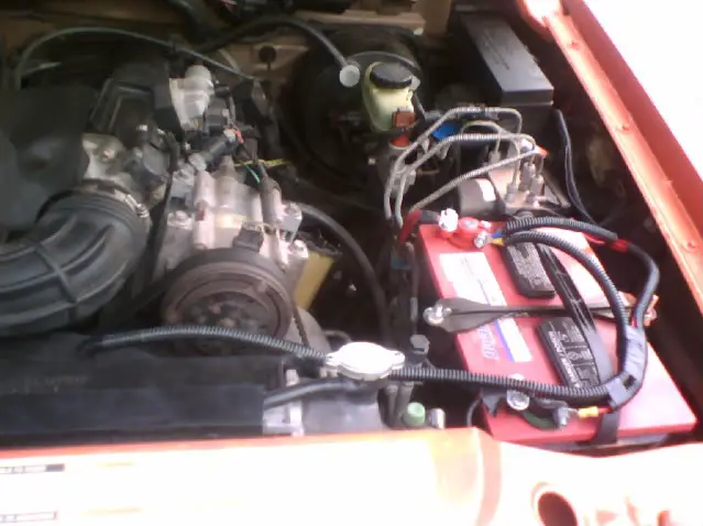

I mentioned before that I was helping a friend install a Taurus SINGLE SPEED fan (1998 Taurus) into his 1988 f-150 with a 302..
I took some pics after the install.. We were designing on the fly so we have extra wire etc. I can pull the fan controller out and sit it on the seat with all the extra wire..

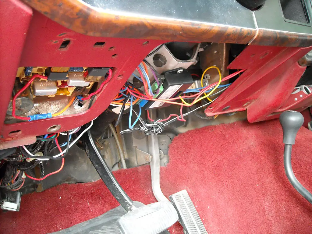

We used the Dakota Digital PAC 2000 fan controller with a VDO 300F sending unit.
We mounted the PAC-2000 under the steering column and I pulled 12 constant and switched power form the fuse box using those taps that plug into a fuse spot and give you two fuses (one is for the orig circuit and the other is for the new circuit).
The PAC-2000 uses push in connectors (push in the bare wire) and has a couple switches you use to control the turn on/off temps, delay timer (how long it runs after you turn off the vehicle), type of sending unit etc..

Here is how we mounted the brackets on the drivers side of the shroud.. and you can see how close we put the fan to the water pump.
Here is how we mounted the bracket on the passenger side.. and you can see the plug we found at a local parts shop to connect the fan.
You can see how we cut the shroud that the taurus fan comes on to make it fit into the factory shroud. We were trying to get as much air to go through the fan instead of around it..

We put an override "on" switch (blue switch) and an a/c override "off" switch (red switch). With the Blue switch on the fan will run (manual turn on), with it off the PAC-2000 controls the fan. With the red switch off (up) it will run the fan only when the water temp is hot (or with the manual override). We added the a/c override since he goes on long trips with the a/c on and this way the fan won't run on those trips since it isn't needed for the a/c when your going down the freeway.
We have it setup to run the following way...
When you turn on the truck it will wait 5 seconds before it will turn on the fan.
The fan will turn on at 210F water temp and turn off again at 200F.
The fan will turn on when the a/c compressor is energized unless the a/c override switch is off.
The fan will turn on with the blue override switch.
If the fan is running when the truck is turned off the fan will run for 30 seconds.
We added an green LED on the dash to indicate power is going to the fan. This lets us know if the breaker kicks or if the relay dies (no green light then).

looks like you know alot except for how to properly crimp wire terminals.
great write up though.
haha.. Yea, I Know. I was trying to teach him but thats how he has "always done it" and since this is in Arizona, he doesn't have to worry about corrosion.
