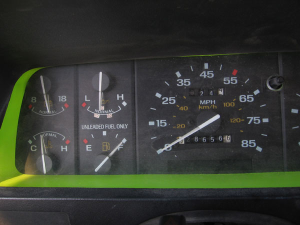

You could always get a little creative too.. I don't remember "why" I took this pic but you can see the mods I did to the cluster one of the times I had it out..
I used a label maker and labed 20, 40 and 60psi on our modified oil pressure gauge (I used an air compressor w/ regulator to find where 20,40 and 60 were on the gauge)..
I also added the 6th digit on the odometer so it would read correctly...
And.. I painted the bezel...
For info on modifying your oil pressure gauge search for fake oil pressure gauge on the forum (I think it might be in useful threads too).. All you do it add one wire (short a resitor) and then replace the factory sending unit with a real one off a 70's ford pickup (bigger sending unit).. then your oil pressure gauge will move with the changes in pressure.

also good points when haveing the dash all apart...nothing like messing around with half a billion torx screws time and time again :rolleyes:
...i think that in a front end collision and damage all the way up to the dash, cluster would stay intact .
I like the green maniak, i was thinking about getting new guage faceplates that light up blue to match my new head unit. i might want to paint mine too. what kinda paint did you use?

Its just flouresant green spray paint.. I haven't been able to find that exact color again as I wanted to use it on the roof rack cross braces. I don't even remember which store I was at.. It was 6 or so years ago when I painted that..
