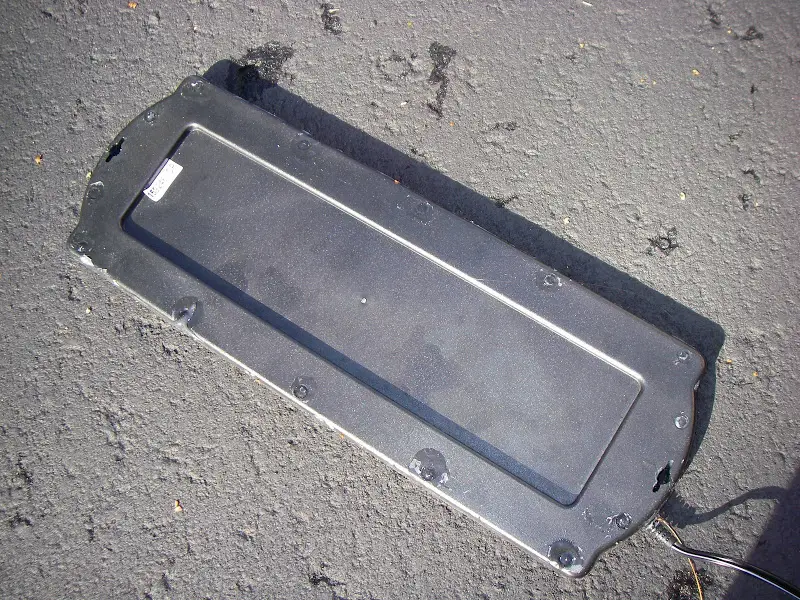

THE INSTALL:
first things first was water proofing. I used a flowing windshield silicon. I like this because it flowed into the cracks. It several applications with the panel leaned in different directions to make it work.
You can see in this pictures I have run a bead of silicon down one edge.
All sealed up
The bottom all sealed up
The install itself was pretty easy. I drilled a couple holes in the factory roof rack. I picked up some stainless fasteners at the local hardware store. I painted them in a flat black so they blend in.
here it is between my PIAA 80 xt pros
Here it is all bolted up
I drilled a hole through the roof on the passenger side and ran the wires through. I cut the clip off the solar panel wire and spliced it into some 12gauge wire. I then ran the wire down the passenger side roof inside the truck and down the passenger side A-Pillar. From there I went behind the dash over to the drivers side and out the hood release gasket. Then up to the battery and done. So now every time the truck is sitting in the sun the battery is being trickle charged!
