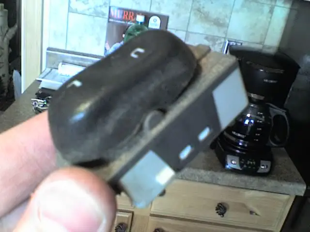

not 100% sure yet. i lost the relay i took out (so the doors would stop freakin out). but i used the interior lamp relay, and plugged it in where the other should have been. the door locks would not unlock very well.
so i started unplugging the switches themselves.. and i think i found the culprit. driver side unlock/lock switch. when its unplugged and the relays are in the lock/unlock spots, it works great. i will go to the scrap yard tomorrow and see if i can get another switch and relay.
here is the culprit

I'd try and find the newest 2nd gen switch I could. Good luck.

i believe there is a master and slave door lock switch. look at the alignment tab for the switch. the slave will have a brown paint mark on it and the master is black like the plastic body.
perhaps a good idea to take one from a donor vehicle from the same side you need it on.

the junk yard only had one 2nd gen there.. and it was a passenger side switch(no driver door). it fits, but its upside down.. i also replaced the relay from one i pulled out of the x at the junkyard.
everything works great!! only problem was i am getting a door ajar light now.. unhooked the sensor for the back hatch glass, and that seems to have fixed the problem. its acted up before, but this time i couldnt get it to go off
