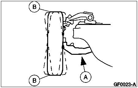

This is the exact quote from the book: (so you are saying its not correct in your experience- Honestly I heard pros tell me yes and no.)....
Raise the vehicle and place safety stands under the (A) suspension arm.
Have an assistant grasp the (B) lower and upper edges of the tire and move the wheel (1007) in and out.
While the wheel is being moved, observe the lower spindle arm and the lower part of the axle jaw. A 0.8 mm (1/32 in) or greater movement between the lower portion of the suspension arm and the lower spindle arm indicates that the front suspension lower arm ball joint must be replaced.
To check the front suspension upper ball joints, grasp the upper edge of the tire and move the wheel in and out. A 0.8 mm (1/32 in) or greater movement between the upper spindle arm and the upper portion of the suspension arm indicates that the front suspension upper ball joint must be replaced.
What I stated is what the book says, yes? In your first post you said "side to side", the book dosen't say side to side, it says "grasp at "A" and "B" and push in and out NOT side to side. Side to side is for checking tie rod ends and such like I said in my first post.

Crap now I'm a little confused, so according to that diagram, if I want to check the lower ball joint, I would hold the lower B and A and push in and out and look for looseness where? I thought the lower ball joint is covered by the tire? How can we see the movement? Or is it just the fact that if it moves, then it needs replacement/ means it is loose.
If it's bad you'll FEEL the wheel move in and out so you won't need to see the ball joint when checking. If it's really bad you can hear it thump when you do it. (assuming the hub is tight and bearing good)

Both ways are valid ways to check for loose ball joints. Sometimes the method shown in the manual isn't as effecient for finding those borderline cases since you don't have as much force behind compared to a prybar being shoved between the knuckle & arm and having pressure exerted on it.
Chilton's manual says 1/32"movement should be replaced. I don't know that I'd be in a rush at that point though. To measure that you would certainly need a helper to watch and make sure it is the ball joint and not a loose hub or worn bearing. Still, I just can't imaging 1/32 of an inch. That what Chiton's says. My 88 Bronco II had a lower ball joint that had damn near a 1/4" slop for a long time with no issues except some thumping noise. My ex is nice and tight tho
