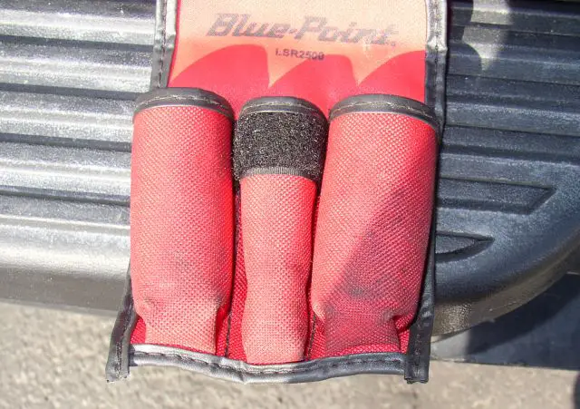

...He said, "Meet your new friend" and handed me this small pouch the size of a cigarette pack...
...He informed me that these sell for about $175 and can be only found at places like Snap-On or Mac tools..
...The pouch contains 2- double ended extracting tools and a 2 1/2"- 1/2" extension bar...These 2 pictures show the difference in size of one extracting socket and the knurls on each of it's inside perimeter...
...You smack the socket on the Key Locked Lug with a hammer...You then insert the 2 1/2" extension bar and I used my 2' long, 1/2" breaker bar and Presto, a piece of cake...:biggthump
