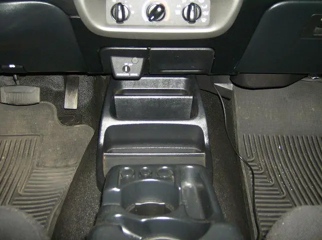

First picture - before (looks like all the others!)
Second - console body

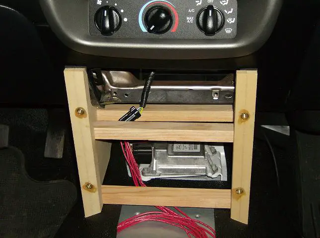

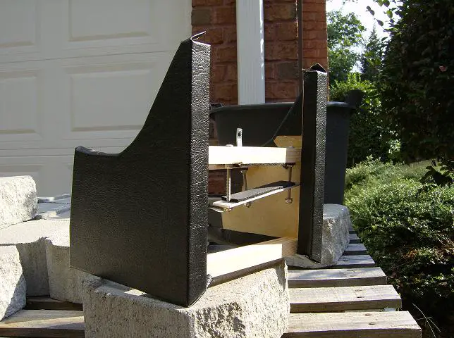

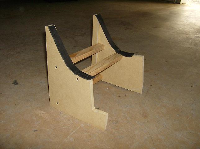

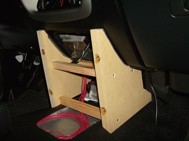

Given my space requirements and the dash layout, I decided to build a console. I removed the ashtray and passenger airbag switch to have room to place the CB radio. Of course, then I had to mount the airbag switch to the console front panel. More on that later...
I made cardboard templates for the side pieces, and cut them out of 1/2" MDF. On the first prototype, I cut some cross pieces from scrap wood to space the sides correctly, and hold them together while trying to figure out how to mount everything. Low and behold, the wood cross pieces turned out to be the way to do it! As an added bonus, I mounted the CB to one of the cross braces too. A way-cool accidental discovery!
As you can see in the pictures, the console is a free-standing unit, that fits up under the dash.
(The hole in the floor mat is from the original console. The silver box on the hump is the airbag deployment sensor. The red wires are part of a wiring harness I made which adds 6 additional circuits/switches.)

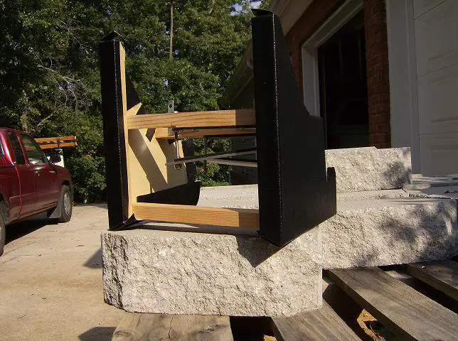

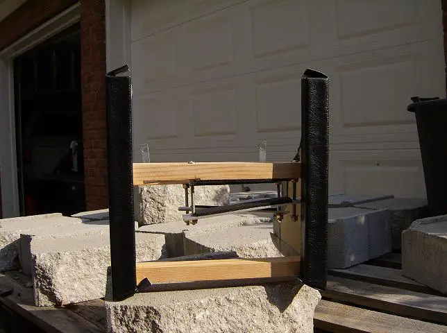

I covered the sides of the console body with vinyl leftover from a tonneau cover project. I used 3M spray glue as the adhesive, and it has held fine for the past 8 months.
In the front, you can see how I plan to mount the front panel. I epoxied in 4 brass threaded inserts. Since their threads are tapered, you can't screw them into MDF - it will split. I drilled holes slightly larger than the outside diameter of the threads, and used a two-part epoxy to hold them in place. The hardest part was making sure the inserts were exactly perpendicular to the face of the console body. If not, the screw heads on the panel would be crooked.
The long screws and aluminum plates are to mount the CB.
The metal "tabs" sticking up are "L" brackets. The line up with existing holes in the dash frame, so I am able to bolt the console to the dash. It is actually quite sturdy mounted this way.

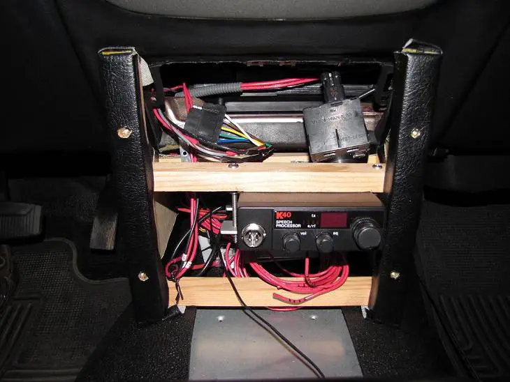

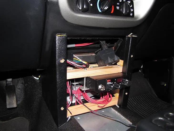

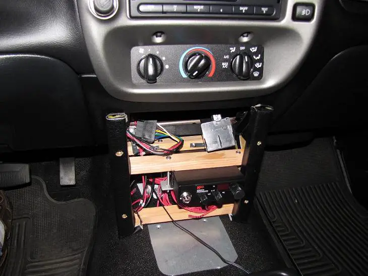

Here, you can see the console in place.
The black square thing in the upper right is the airbag switch. The trailer light connector is part of the wiring harness I built for the gauges. The radio is mounted. The red coiled wires are switch feeds, and the black and red wires to the left are power feeds.

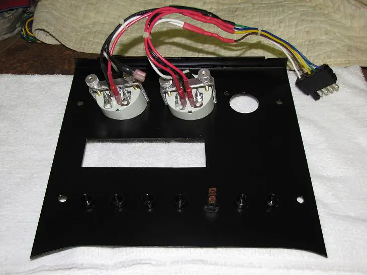

Now for the front panel...

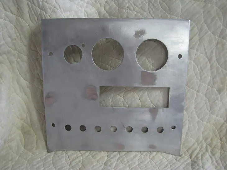

The panel is built from 1/8" aluminum sheet. The top has a 90 degree bend (and them some, to fit tight to the dash) - the bottom matches the curve of the floor.
The layout consists of the 4 mounting holes, the airbag switch (with indicator light), 2 gauges, CB, and 7 switches. There is room next to the CB to add something later, if need be.
I sanded the panel, and filled the scratches with glazing compound. The end result was quite smooth.

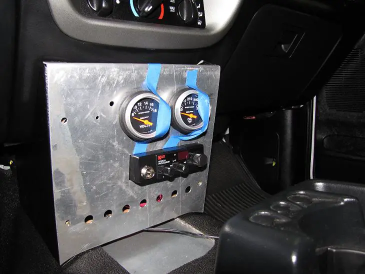

Here are some views of the panel during layout. (This was before sanding - you can see my local fab shop did not bother to cut the aluminum from a new piece.)

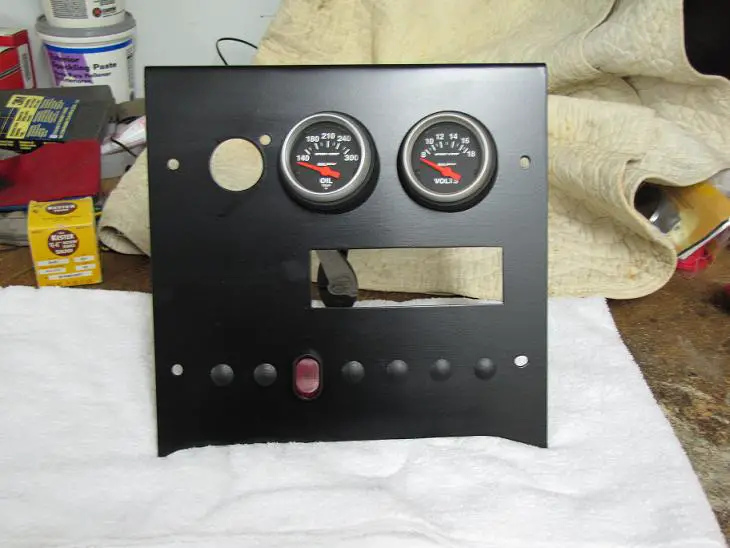

Primed and painted with Rustoleum Satin Black. Autometer Sport Comp gauges installed with angled collars. (You can see the other half of the gauge wiring harness.) One switch and 6 plugs installed.

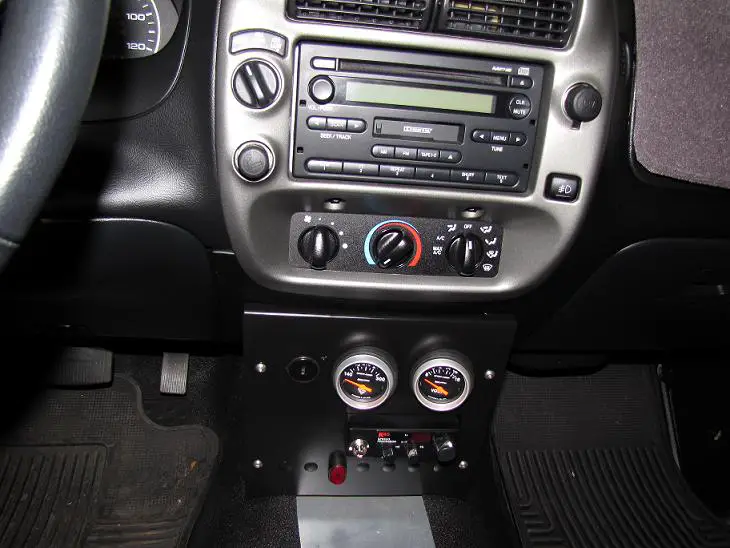

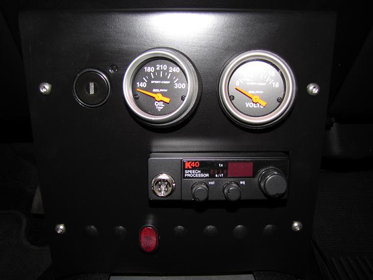

The final result!
Yes, the gauges do not face me directly, but they are not that difficult to read.
I used stainless steel round head allen machine screws to attach the panel to the body. I thought about using chrome screws, but they would not match anything. The s/s is close to the aluminum trim ring color.

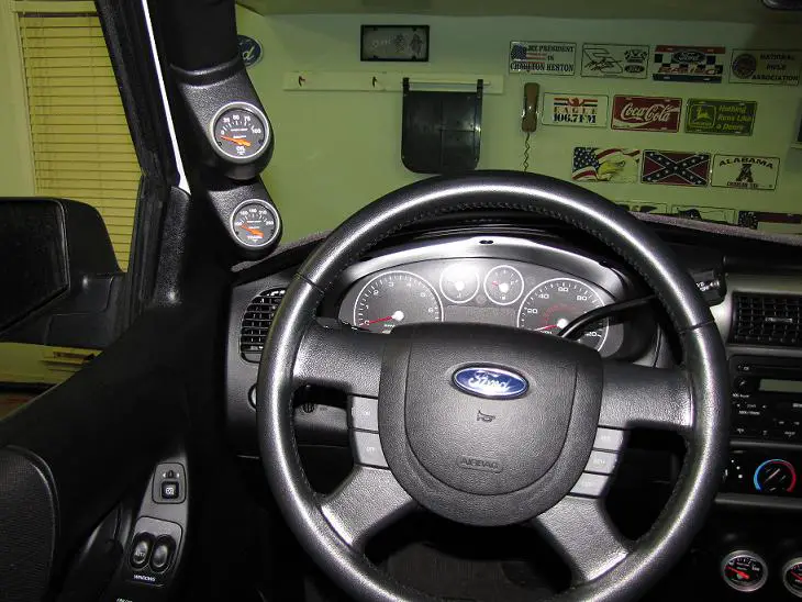

Here is a view of the other gauges in the A-pillar and the factory instrument cluster.
(You can see part of the console in the lower right corner.)
