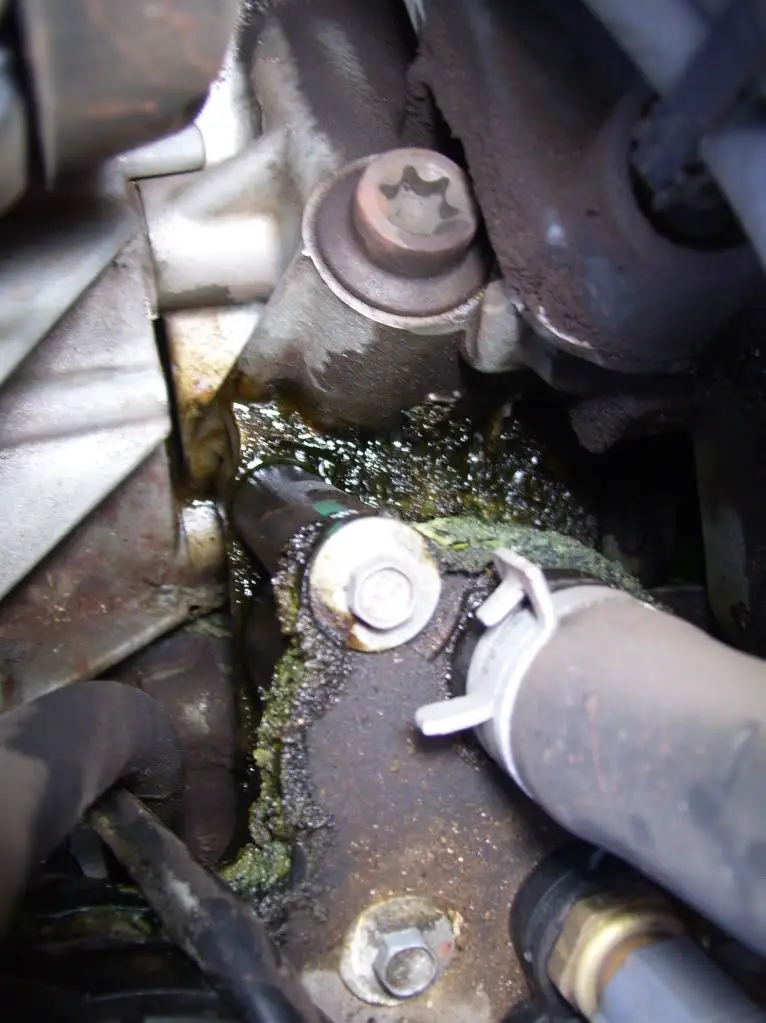

My wife has a 2002 Explorer XLT V6 4.0L SOHC with about 100K miles. There is a coolant leak that I cannot find the source of. I have changed out the thermostat, water pump (and gasket), and the upper and lower radiator hoses. It still leaks.
I have checked the engine oil and it appears okay. The Explorer does not emit any white smoke.
I can't really tell where the coolant leak is coming from, but it appears to start somewhere up and behind the water pump - the alternator is in the way. The coolant runs down the front passenger side of the engine and falls on/behind the front cross member.
It is a pretty steady leak. It only leaks when the engine is running. When the engine is off I can fill the reservoir without it leaking (as far as I can tell). I have run the heater successfully and have confirmed that the thermostat is working correctly (upper radiator hose gets hot). I have not done a coolant system pressure check yet.
Some of the other posts point to possible issues with either the timing chain cover gasket or the upper/lower intake manifold gasket. How difficult are these jobs to do for someone with intermediate skill? How expensive (roughly) would this job be if I took it to the dealer or a repair shop?
Any tips/ideas/suggestions would be welcome.
