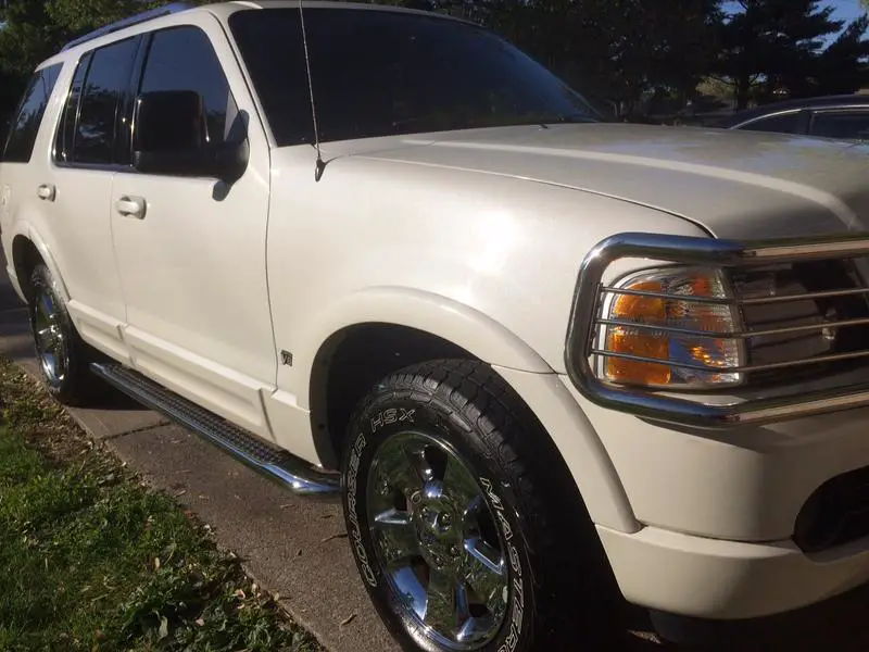

I am currently using chrome step bars from a 2005 Sport Trac Adrenalin on my 2003 Ex Limited. However, you must be very careful if you consider doing this. First, you must have brackets from the regular 4 door, ST brackets are very different and won't bolt onto your vehicle properly. Secondly, the ST has a longer wheelbase and therefore slightly longer step bars. You cannot use them if you have oversized tires. I only use these with my stock tires 245-65-17 and there isn't a ton of clearance. I have run 265-75-16 in the winter and I swap out my chrome ST bars for stock length 3rd gen bars, for clearance reasons. If you use ST step bars, you will also have to drill new mounting holes in the bars under the step tread to line up with the mounting brackets. I have never seen anyone else use ST step bars, but I do like mine as they are unique.
Here are some pics that show the ST step bars and the last one is of the original Limited CK running board. I don't like the closed in styled of the original ones, they trap the dirt, snow and salt right up against the rockers.
