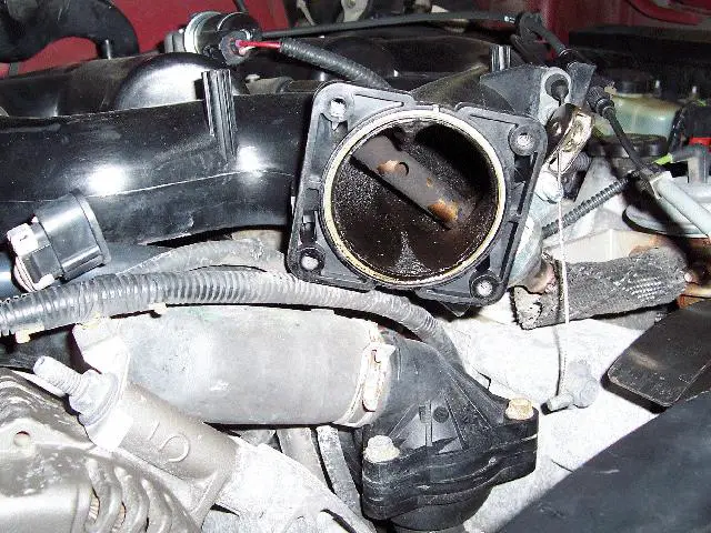

There is a lot more build up of deposits in my SOHC upper intake manifold than in the main intake tube. At first I thought that the deposits were coming from the PCV port on the passenger side valve cover. Then I learned that the port is an inlet instead of an outlet and the flow would only be reversed if the PCV valve was blocked. I checked the PCV valve and even though it was dirty it was still functional. Now I suspect that the difference in build up is due to the exhaust gas recirculation (EGR) tube that is located just downstream of the upper intake inlet. The photo below shows the EGR tube in the upper intake manifold after the throttle body was removed.

However, even when the EGR system is working as designed it results in carbon buildup in the intake system. I noticed when cleaning the crud out of my intake system that certain sides of a chamber or port have more deposits than the opposite side. I'm speculating that this may be due to airflow directional change. Particles in the exhaust have more mass than air and would seek a larger radius (if possible) in a turn. I'm wondering if some type of velocity separator (particle filter) could be built to reduce the particles in the exhaust prior to entering the intake system - or even the EGR components.
I have to agree with the polluting the engine part. This is the intake on my sons Oldsmobile I took apart yesterday. That black pile of tar like goop in the bottom center of the intake manifold should be an opening about the size of a dime. Its the passage from the egr valve to the intake, plugged solid at 75k miles, error 401 low flow, 6 hours latter, problem fixed.
