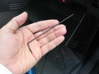

Step one was to pick the door up off of the bottom of the box. I tried using my fingers and curved rods to try to grab it via the box grate but that didn't work. The box is deep and you can't grab it. So, I drilled a couple of holes in the side of the box toward the bottom in order to stick a screwdriver or something in to pry the door off the bottom. I ended up using a long thin allen wrench.
As I lifted the door up with the Allen wrench I used my other hand to grab it through the box grate with a rat tail file and maneuvered it back over the outside vent opening where it would be if it were closed. I jammed the file into the plastic grate and it held just fine.

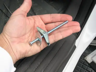

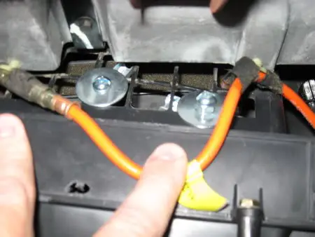

I needed something to permanently hold the door in place so I came up with using toggle bolts. I used a 1/4"x4" machine screw with the toggle. The spring loaded toggle will latch onto the box grate and the screw part will butt up against the door, holding it in place. I added a large flat washer to keep the assembly from falling down into the box (but not before it happened once and it took me nearly an hour to fish it out.)
I ended up using two bolts. The angle of the box grate makes it so the bolts go down at a slight angle and impact low on the door. Not ideal but it seems to hold.
I have no idea how long these things will hold up. If I had to do it over I'd go with a little longer screw. The 4" just touched the door when it tightened on the vent grate. A longer screw might allow adding a lock washer or nut to make sure they don't loosen over time.

It's been about two weeks and the bolts are still secure. Air flow from the A/C is excellent.
