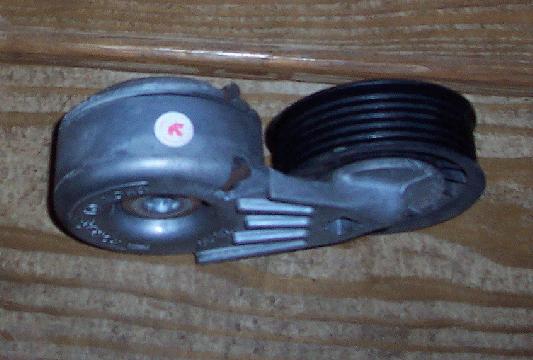

Photo of serpentine belt routing
The following photos are from my 2000 Sport:
Serpentine belt routing
Idler pulley
Tensioner
