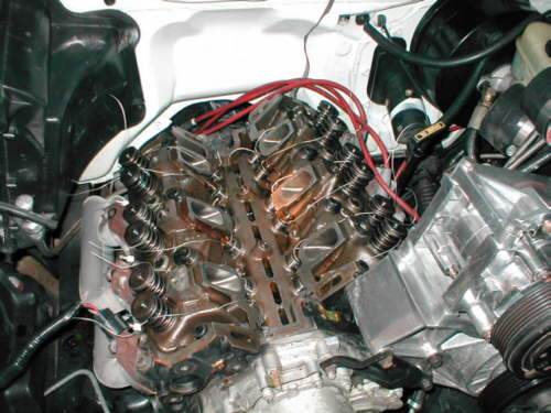

These first pictures help to dispell the doubt that you must remove the heads to remove the cam because the lifters won't come completly out of the bores with the heads on. I use to think it wasn't possible myself until Sven told me otherwise. I used steel tie wire used for safety tie wiring bolt heads. I think its .035 stainless steel wire. Its available at any good parts house, not autozone.
Lifters held by wire
Lifters held by wire, close up shot

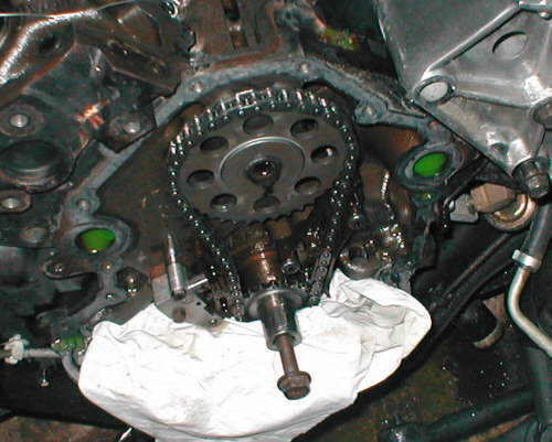

This next picture shows the timing chain and tensioner. There are two 10mm headed bolts that hold it on. Also, note the CLEAN shop rag stuffed in the front of the oil pan to help prevent any debree from getting in the oil pan and it also helps catch those two 10m bolts if they happen to fall. Also, you may wanna go ahead and line the engine up on TDC before you remove the chain, on the 4.0 TDC is the keyway straight up on the crank. The torx head bolt on the cam gear is a Torx T55.
**Be careful, when you remove these two bolts the tensioner will spring apart. There will be a long spring inside the tensior along with a small metal peice that rides behind the plastic arm**
Camshaft tensioner and chain

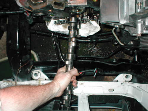

Finally the cam removal. You must remove the radiator and I'm not sure but you MAY be able to slide the a/c condensor up enough to get the cam out. As you can see by this picture it comes all the way out past the core support, so the a/c condensor must be moved a bit. I don't have a/c so its not a problem with mine.
Camshaft Coming out
I hope I've helped a little to show you whats involved in removing the cam from a OHV 4.0. I didn't go over stuff like timing cover removal or lower intake but if you gonna swap the cam you should know that you'll have to remove those as well. don't have my new cam yet so I'm kinda stuck for this weekend as for reassembly but I think the wife would be upset if I did try to do it on Mother's day anyways .
Camshaft Coming out
