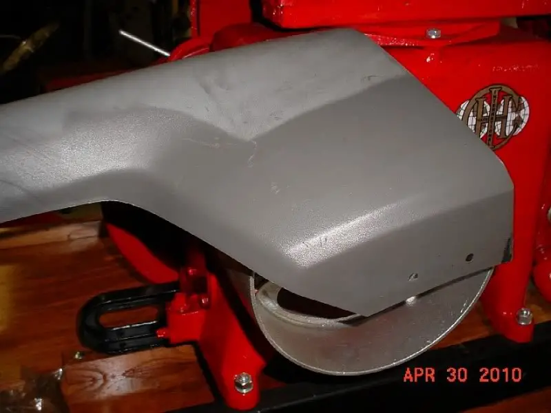

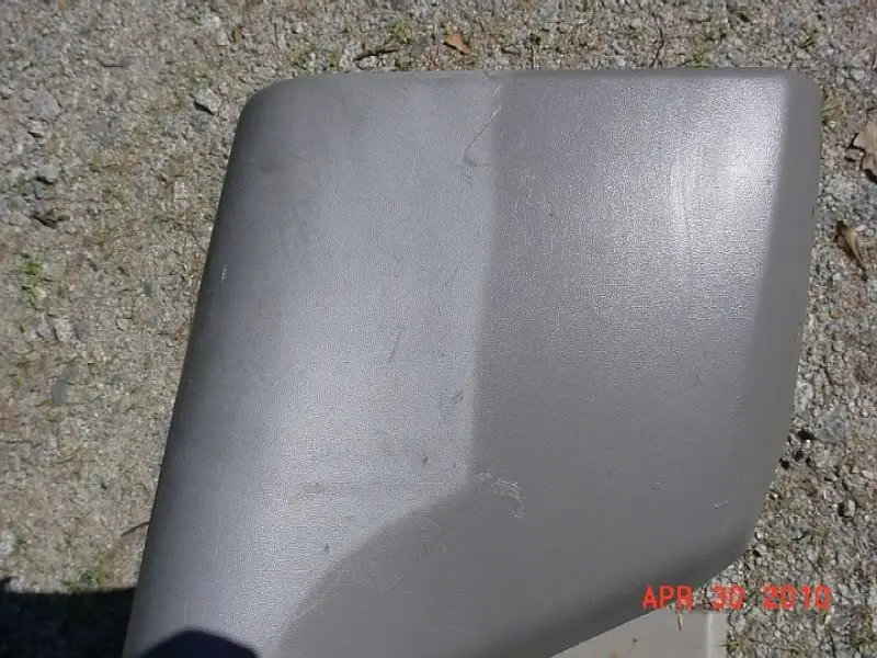

I got out one of my old pieces of gray cladding and tried out the heat gun on it today. I'll let you be the judge of the results.
In the outside sun light:
Inside the shop, with flash:

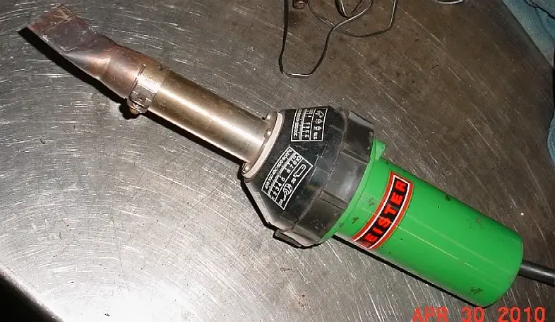

The heat gun I use:
I don't know what results you would get from, say, a hair drier. This is one bad mammyjammy heat gun. Used to light my cigarettes with it, before I quit. It will melt the earth! Extreme care I have to use or I'll just melt the plastic.......:D:D
Bottom line, this works! Guess I'll be doing mine soon!;)
Heat gun is a good tip. seems to look better at least in photos. I just use tire shine on my plastic pieces too
That is a hell of a heat gun! I have one that I use for underground splicing and heat shrink tube, etc. I wonder if it will work? I'll have to try it after the black magic wears off!!:salute:
those results are really good!
I was thinking about using the same thing, the heat shrink gun. I think it might work, and have less chance of melting the plastic than that commercial grade heat blaster! That thing looks awesome though.
