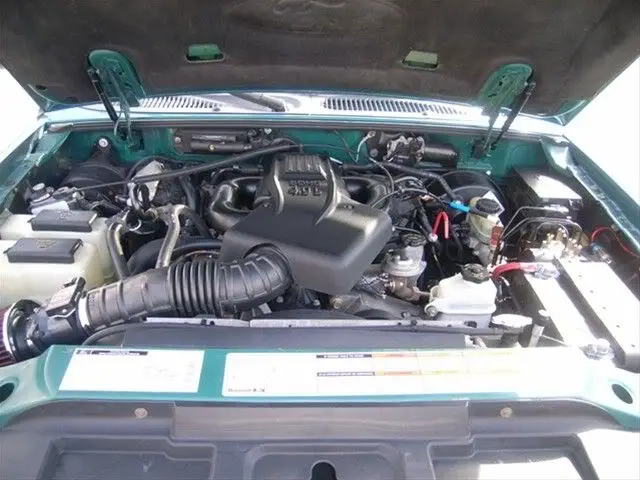

Here's a picture of a Job 1 Sport Trac engine bay...
Courtesy of EF member GAZH13
Here's a picture of my Job 1 engine bay with that cool cover removed. :D
If your intake looks different than these pictures, than you have a Job 2 Sport Trac.
