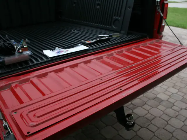

Here is what you receive in the box, everything you need to get it hooked up and working in no time.

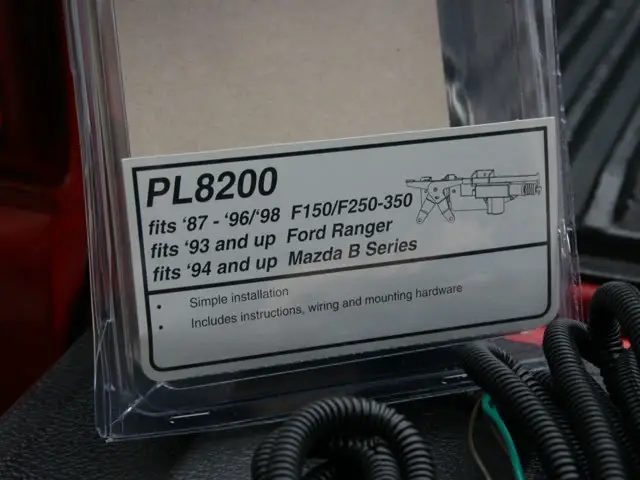

Here is the part number for future reference.
Lets begin,

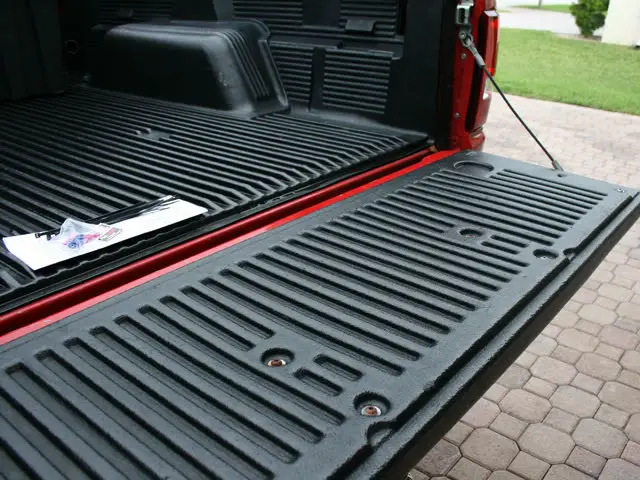

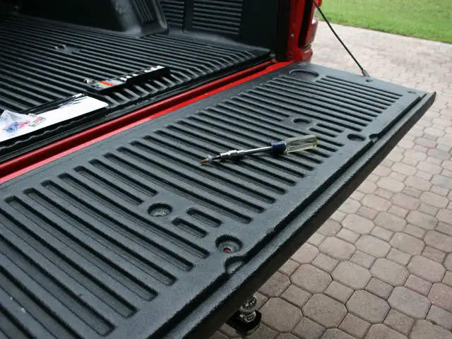

Since this truck has a plastic bedliner it will need to be removed to get to the access panel.

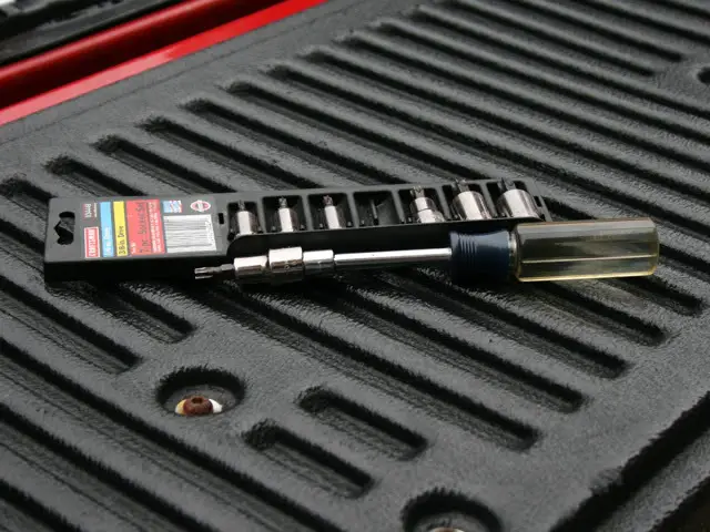

T30 Torx is required to remove the screws.
Start removing the screws.
With them removed, remove and place the bedliner piece out of the way.
Remove and place the access cover out of the way.

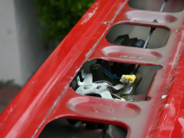

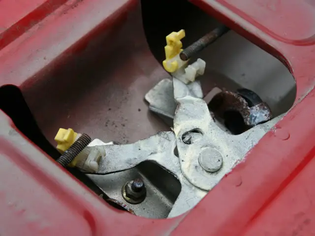

This needs to be removed.

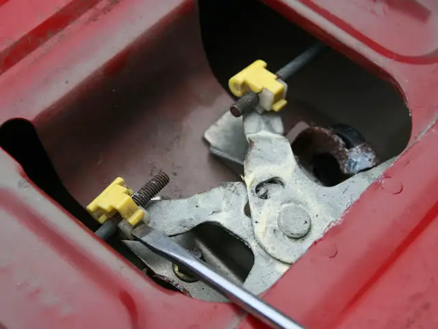

But first it needs to be disconnected, a flat head scewdriver will take care of that problem.

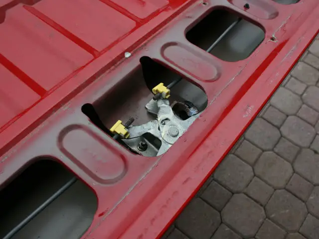

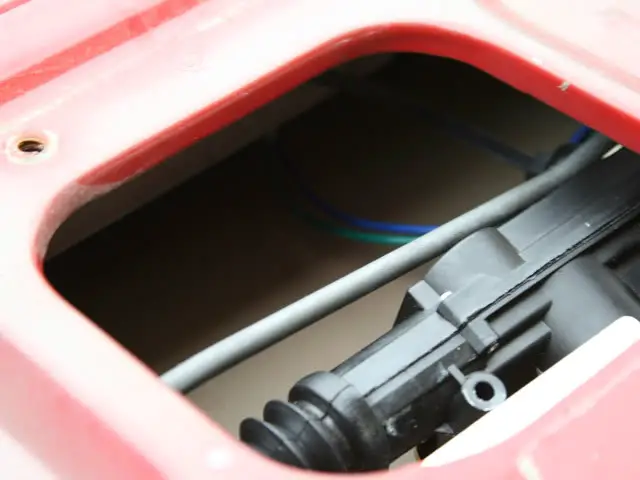

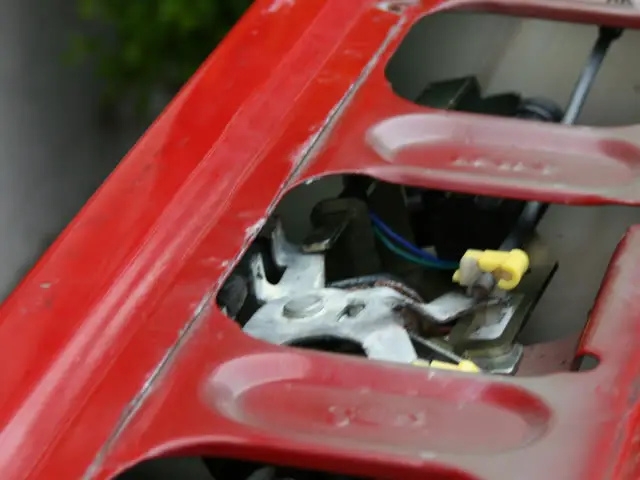

Both are now open.

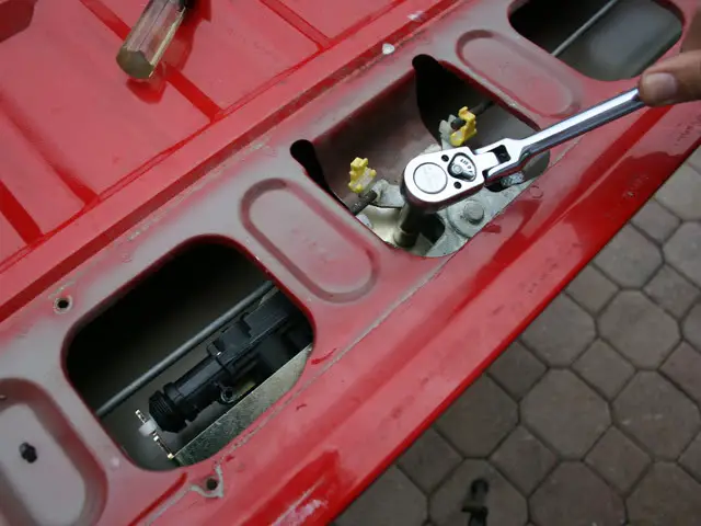

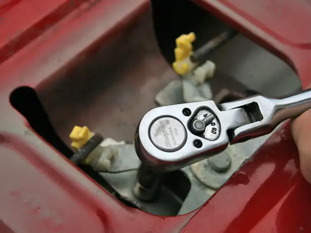

Remove the two bolts holding it on now.
Remove the handle piece and then slide the lock into place.
Put the handle piece back in place, then put the lock in between the bolt and nut like a washer. Now tighten it back down.

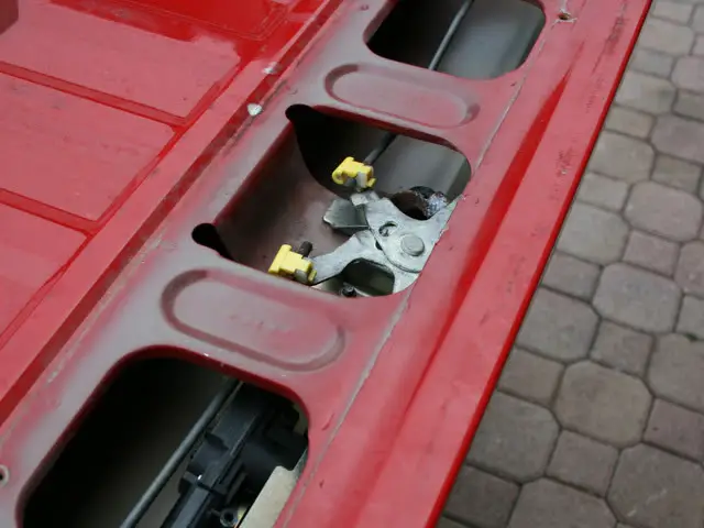

Lock and handle pieces are in place and secured. Now reattach the linkage rods, make sure to adjust them so that the tailgate can not open while the lock is in the locked position.

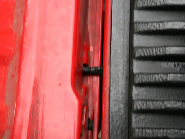

Now lets see how it works. In the first picture the bar is pulled out and in the unlocked position. The second picture it is pulled in and in the locked position. This will not allow to tailgate to open.

Wires are connected and secured out of the way of any moving parts.

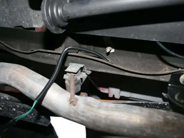

Here is the wire dangling under the truck.

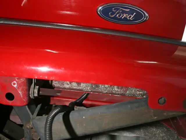

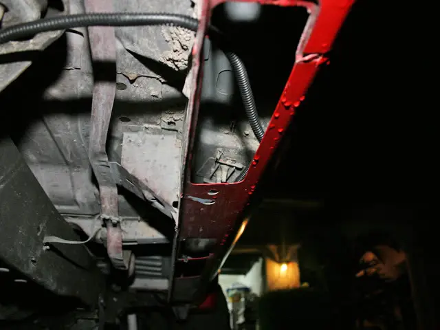

Start to route it through the frame.
The extension has been plugged in and the wire is being routed. I was unable to run the wire entirely through the frame, the exhaust gets very close and it would get too hot. So I started to run it in the rocker panel which is far from the exhaust and is where the wire needs to end up anyway.
Up the rocker panel.

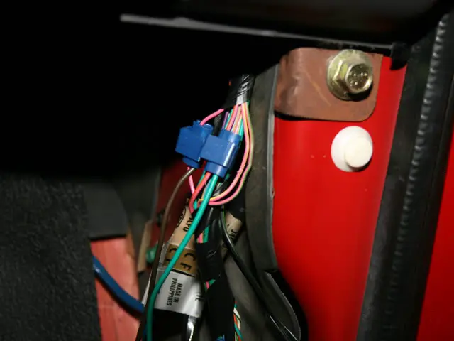

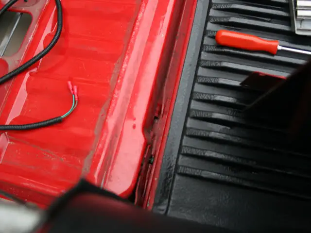

I came up through the drain plug (make sure to cut wire loom so drain plug still has a seal. The wires for the passenger lock are right in the passenger footwell, all you need to do is connect them to your new wire via a wiretap. Please note, in the picture they are hooked up backwards. If you hook it up backwards you can unplug the bullet connectors that attach the wiring harness to the lock itself and switch them.
